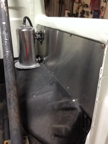

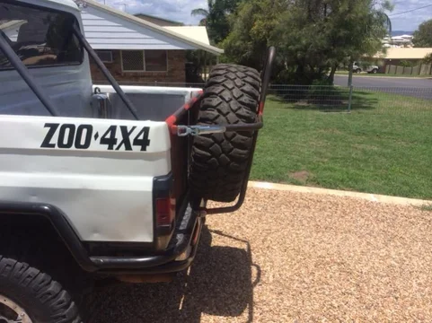

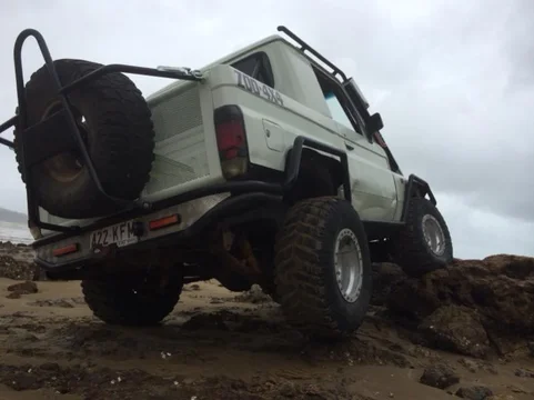

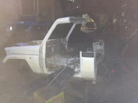

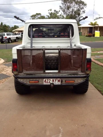

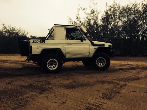

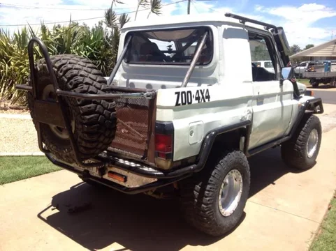

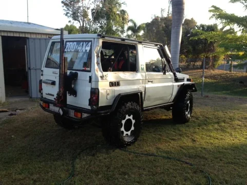

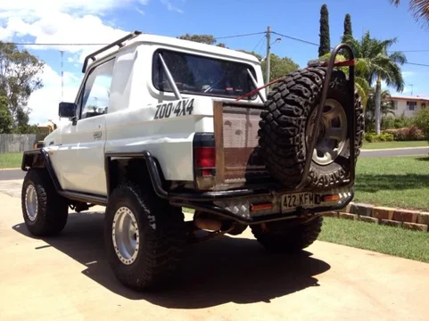

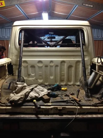

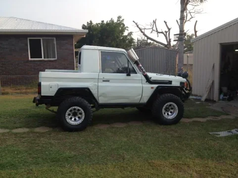

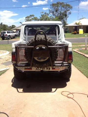

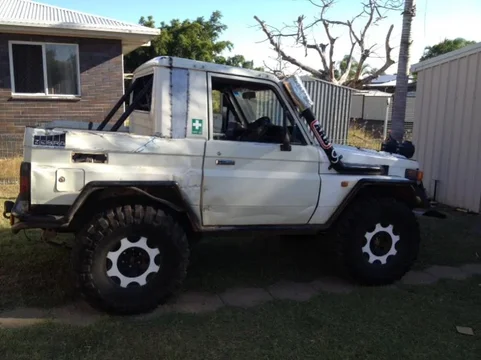

After my last winch challenge but back window connected with a tree. So I decided to cut it style side using the rear of a 79 series ute.
This is how it turned out

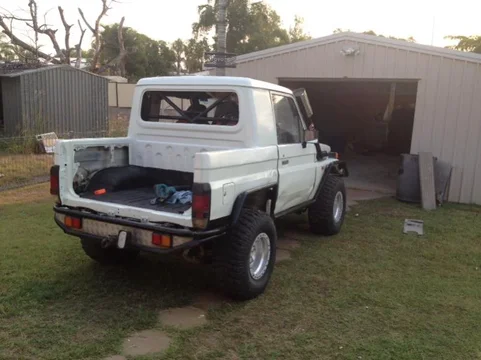

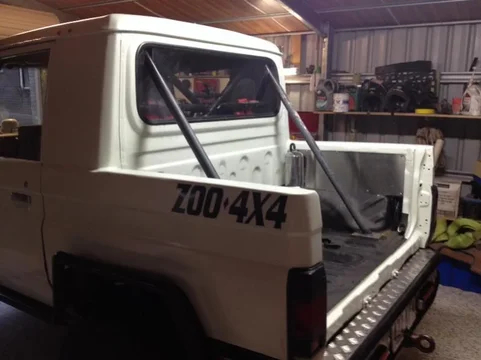

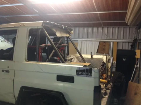

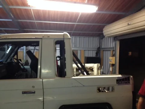

I had a few small issues, one was the 79 roof was 10mm higher than mine with the gutters lined up. So I cut a v into the corner of the roof, folded it down and tacked it up.
Iv put the rear window in and welding the rear stays back on
Il be knocking up a tailgate in a few weeks so il keep you's posted
