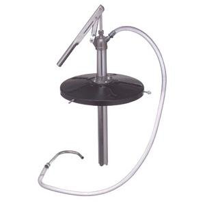

hand pump
This would help in filling up.
When looking for the 5 gallon pail pumps, look at the capacity per stroke. I'm seeing allot of the cheaper ones being only 1oz per stroke. All of the ones I have are at least 4oz per stroke.
