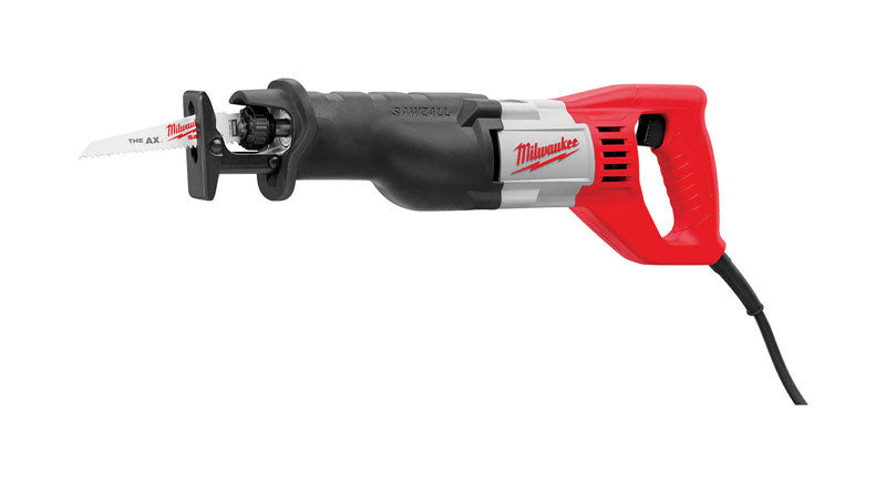

Ya I didn’t pick up a 80 to be a mall crawler and LARP off road.
In that case, zero lift...
