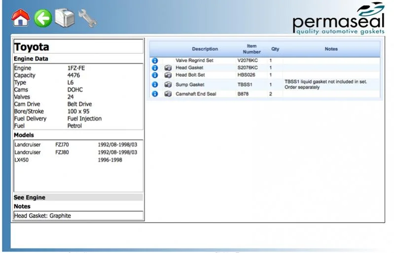

Well I'm not planning on hot rodding this truck and I'm not a lead footer. 6psi is all I am planning to run. Was thinking about Permaseal's 4-layer metal/graphite gasket. We'll see. Its funny how the gasket landscape has changed so much in the 20 years since I did this stuff. Of course if anything more than 0.004-0.006 needs to come off then I may need to re-evaluate again.

Yeah I know the new toyota gasket is way better than the old one but one thing to consider is an aftermarket headgasket. Cometic makeS MLS gaskets and they can do custom thickness. It is an opportunity to think about adjusting your compression ratio with a thicker gasket. If you want even more sealing power they have their phuzion gasket. The nitrogen filled o-rings require no grooving of the block and or head. They hold a more constant pressure between the head and block than a traditional fire ring.
Phuzion Gaskets
Well I'm not sure just how nuts I should really go with it. Phuzion looks interesting but I need to do more digging.
