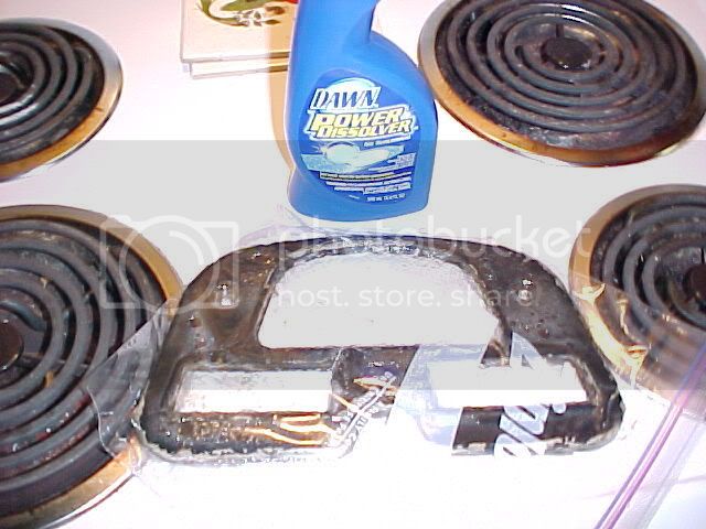

Couple of things....I put small pieces in ziplock bags to slow down evaporation, helping the stripping process...Larger pieces, body panels, etc. can be wrapped with saran wrap after spraying with power dissolver...

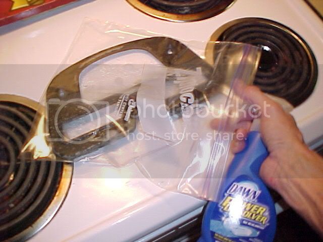

Here is the process I use: (sorry the pics are less than good quality....you'll get the idea though)

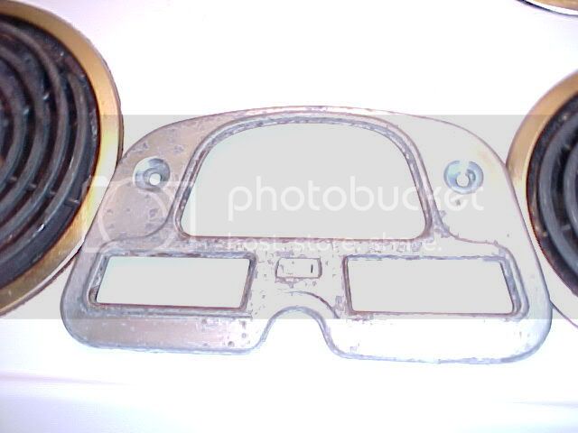

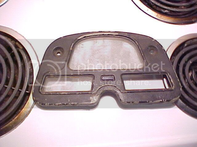

I wanted to strip the gauge bezel to reprime and paint....
After I removed the glass, I put it in a gallon ziplock bag...(Left rubber glass retainers on the bezel)....Sprayed the power dissolver into the ziplock bag...

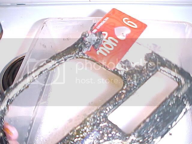

Closed the bag and left it overnight....Works in as little as 30 minutes for some light paint removal...

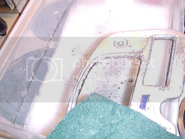

Took the bezel out the next day and started wiping off the paint with an old Victoria Secret gift card.....:)

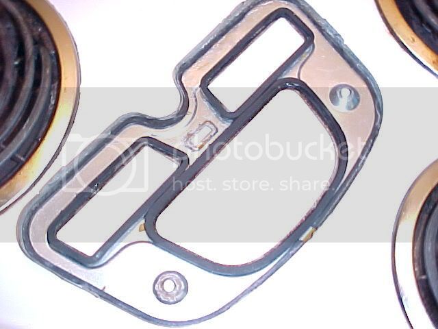

Follow up with Scotchbrite or steel wool...
Take care of a little surface rust before priming/painting and its done...(this pic is really stinky...sorry)
Rubber glass retainers stayed fine with no damage from the power dissolver...(no damage that I'm aware of ;))...
