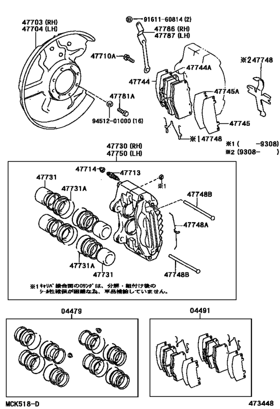

I'm now reinstalling the brake callipers which I had taken off last winter for a rebuild and am wondering if there were/weren't lock washers on the two bolts which mount each caliper to the knuckle ears (90101-12144)? The FSM only mentions bolts, no washers so I'm tempted to put them on as is.
Thanks to all who pitched in!
Turns out there are two small brackets that go under the bolt heads (47786 and 47787 in the picture below) which serve to reinforce the edge of the disk brake dust cover. They appear to also act as a washer.
