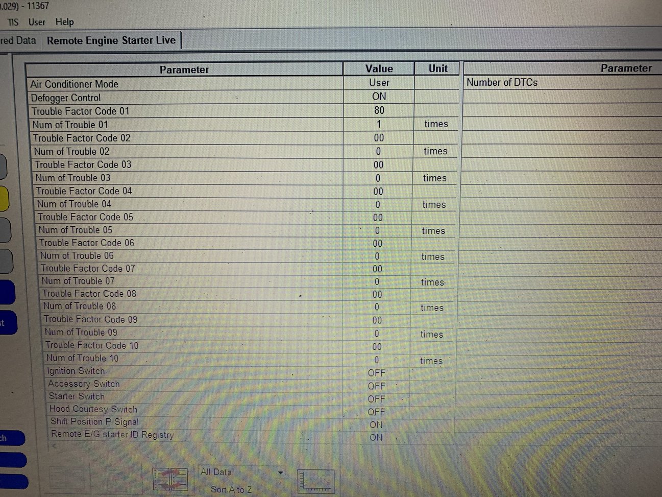

These installation instructions should offer some guidance as well. Side note for someone who reads this later with a Canadian 460... this won't work on those vehicles. I installed this OEM kit on my '12.
Example of what you would see for troubleshooting in TS using screen from the CL install thread I linked to above.
