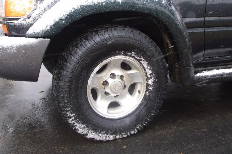

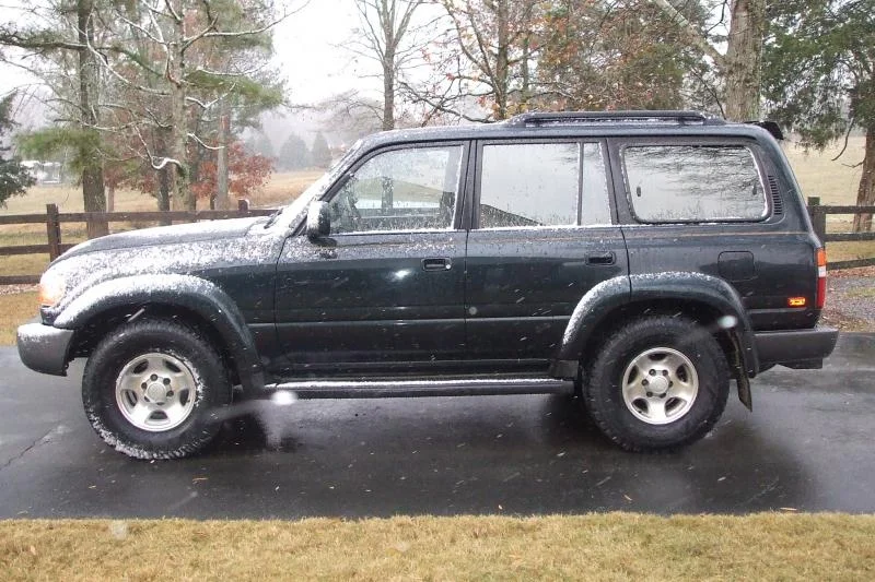

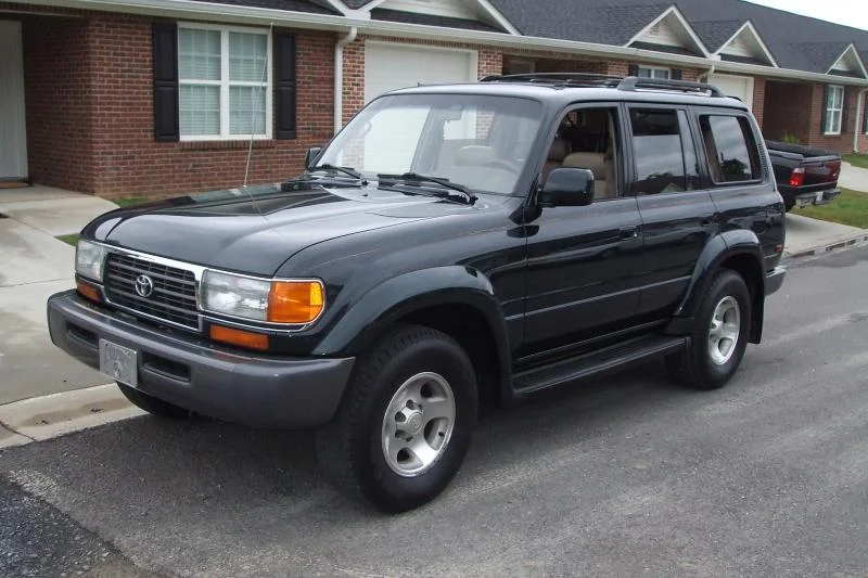

I thought some of the stock cruiser owners would like to see what 285 BFG's make the truck look like. My truck has a stock suspension, no parts replaced yet. Original tires are the first picture. Enjoy!!

We had about an inch of snow, but it only lasted about an hour. I haven't noticed a significant loss in power. Honestly, the ride quality is what I noticed the most. There is a little more roar, but the softness of the ride and lack of road noise far out ways the roar. One note, my LTX's were probably 7 years old, they were so dry rotted that the beads broke off when the tire store tried to remove them. I only had one tire of 5 that I could reuse as a spare. So far, I really like the tire. I am planning a stock height replacement suspension in the spring.
