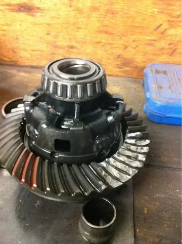

I broke my front diff (2000 LC) at Cruise Moab on Gold Bar Rim trail. Many folks wonder how strong the 4 pinion diff is, well I have a video of what it takes to break it. Was thinking with my driving style it would last me a long time. Well I got a little too aggressive and was not paying close attention to what the vehicle was telling me. Pretty sure if I was driving and paying attention I would have gotten up this with no drama.
From the video it survives a number of bounces and a lot of stress before failing.
What failed was the ring gear, 7 teeth broken off. The spider gears are in great shape, have no play.

Photo of Ring gear

This is almost exactly how I broke my 4-pinion front diff (climbing obstacle, front wheel off-loading, then landing...) , and also the failure point was exactly the same (i.e., it was the ring gear teeth that gave up rather than the pinion gear(s))
I've been happy with the Nitro 4.88's and ARB front diff since then... that said, given that it was the teeth on the ring gear that failed (not the diff proper per se), it makes me wonder just how much more strength my current setup has... perhaps in practice it's the ability to lock the front, which prevents this kind of shock load that is the real reliability improvement (I don't intend to test it to find out...)

The picture looks like it was just the ring and pinion? I would say the 4 pinion diff held up but the ring and pinion did not no?
Many times stock R&P are used with an ARB. The exception (making it the diffs fault) would be if the diff flexed leading to the R&P failure.
