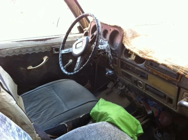

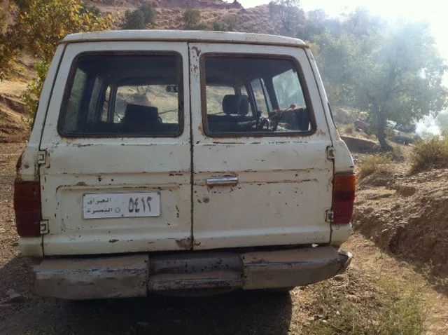

A friend from Iraq sent me pics of his new ride. Nice interior!
