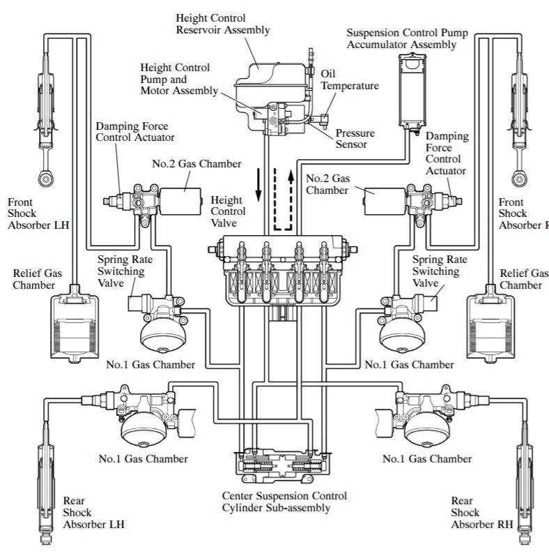

It'll help to have a diagram to talk about aspects of the system:
You can see that AHC is exceedingly complex. They don't dream this stuff up for the sake of complexity, but for measurable objective performance. It's way beyond a system that can be produced in the aftermarket which is why I say it's a suspension system on steroids. What this doesn't even show is the software and control logic that dynamically runs this system.
One-way to think about AHC is that it's a computer controlled remote reservoir pressure and damping system. The magic doesn't happen in the shock body. That part is a simple hydraulic ram.
The fact that it's a remote based system, lends it heat sinking and dissipating qualities, probably more than most aftermarket remote-res systems. It has relatively huge fluid volumes. With lots of surface area. The system is pressurized as it also supports some portion of the weight of the vehicle. And note the Relief Gas Chambers. So it has the characteristics and mechanisms to minimize fluid aeration issues that causes damping to degrade in extended washboard use. Not saying it can't degrade, but it has the right stuff for it. There's software logic too to respond to these situations, to minimize thumping and maintain posture. BTW, I've chased a Raptor in the dessert washes for hours. I didn't note any fade, and I'm particular about suspension performance coming from the road coarse world.
In regards to your question. Damping and height are handled by different components. Height via the Pump, Height Control Valve, and accumulators that controls fluid volume. Damping via the Damping Force Controller, Center Suspension Control cylinder Sub-assembly, and Gas Chambers. Many of these components have heat sink fins on them to ensure they are performant under extended load.
