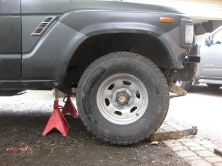

You sure those front springs aren't too long?
Looks like when you get weight on them, the shackle may bottom out the opposite way no?
Yeah I noticed that, I have extra hangers, so when I do my body swap if the shackle angle is too severe I will cut the old hangers off and weld some new ones on.
errr... it's gonna look a little like this.
attachment.php
BattleWagon is that your truck? If so did you drive it at all with the shackles with that severe of an angle?
Gotcha, well I'm going to angle the pinion up a bit and do a cut & turn to address the caster.
It would have some killer droop, but I personally would like to see the angle closer to 45*
stevo on my 63'' chevy springs my angle is 50 degrees and it seems to work perfect
