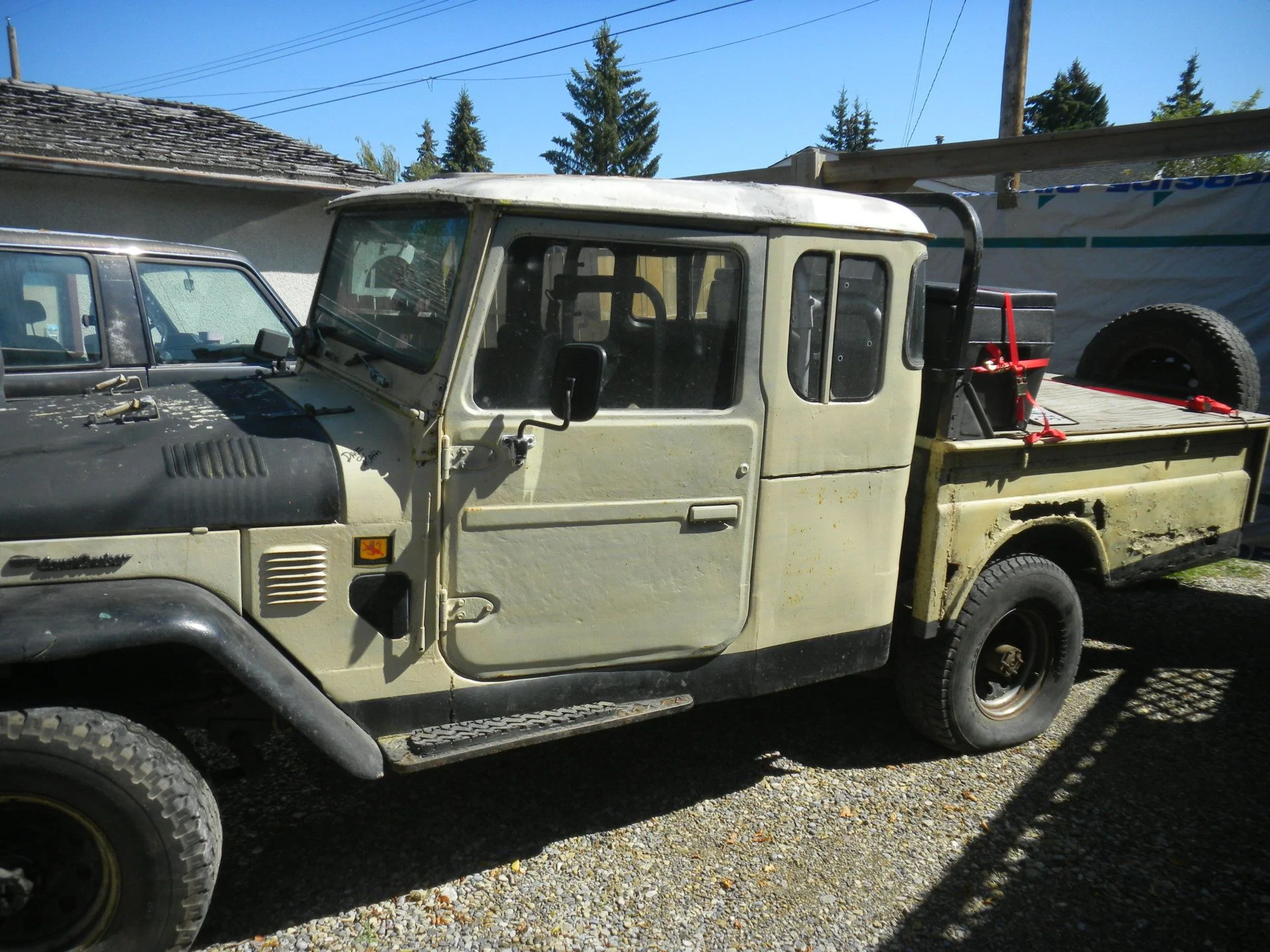

Not sure if the thread is still active ? this is a 78 fj45 with added extra cab. It's my own build. I also rebuilt my bj 42 in Stainless steel, half cab.
I love the 40/45 series and am open to doing projects and for hire. I'm currently thinking of a 44 or a 46 version.
