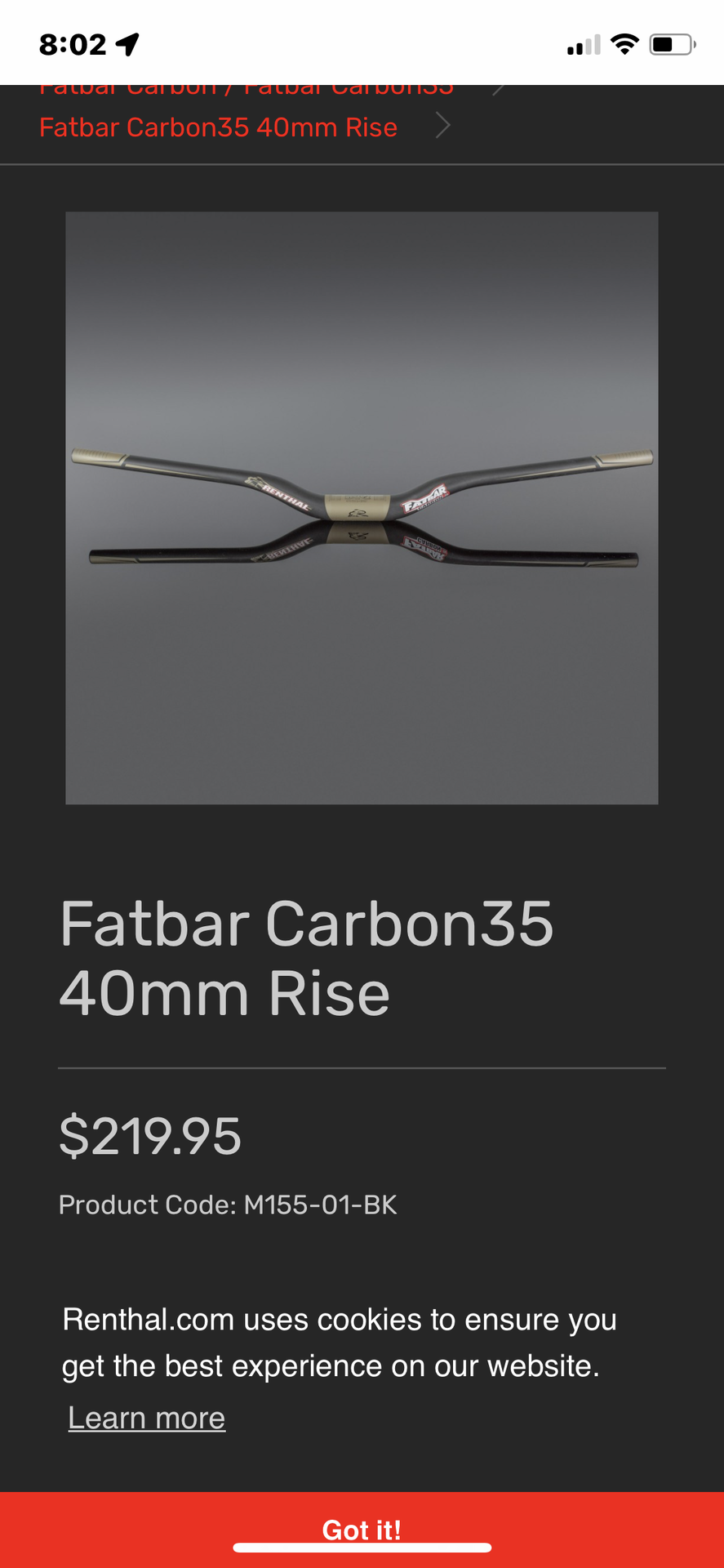

Take a look at Renthal riser bars. They have a lot of options and are light weight high quality bars.
i got a one up 35mm rise. it is probably 2 cm higher than my stock bar. hopefully it’ll be enough. it sure doesn’t look like that much of a difference but it is when i measure it. if its not enough i’ll have to get a 50mm. the only problem is that any carbon 50mm i have seen have 31.8mm centres and i have a 35mm bar clamp. i’d rather not buy a new clamp or spacers if i don’t have to so hopefully this will work. i can always use this on my canyon if i need to though so it won’t be a waste if i still need more!
