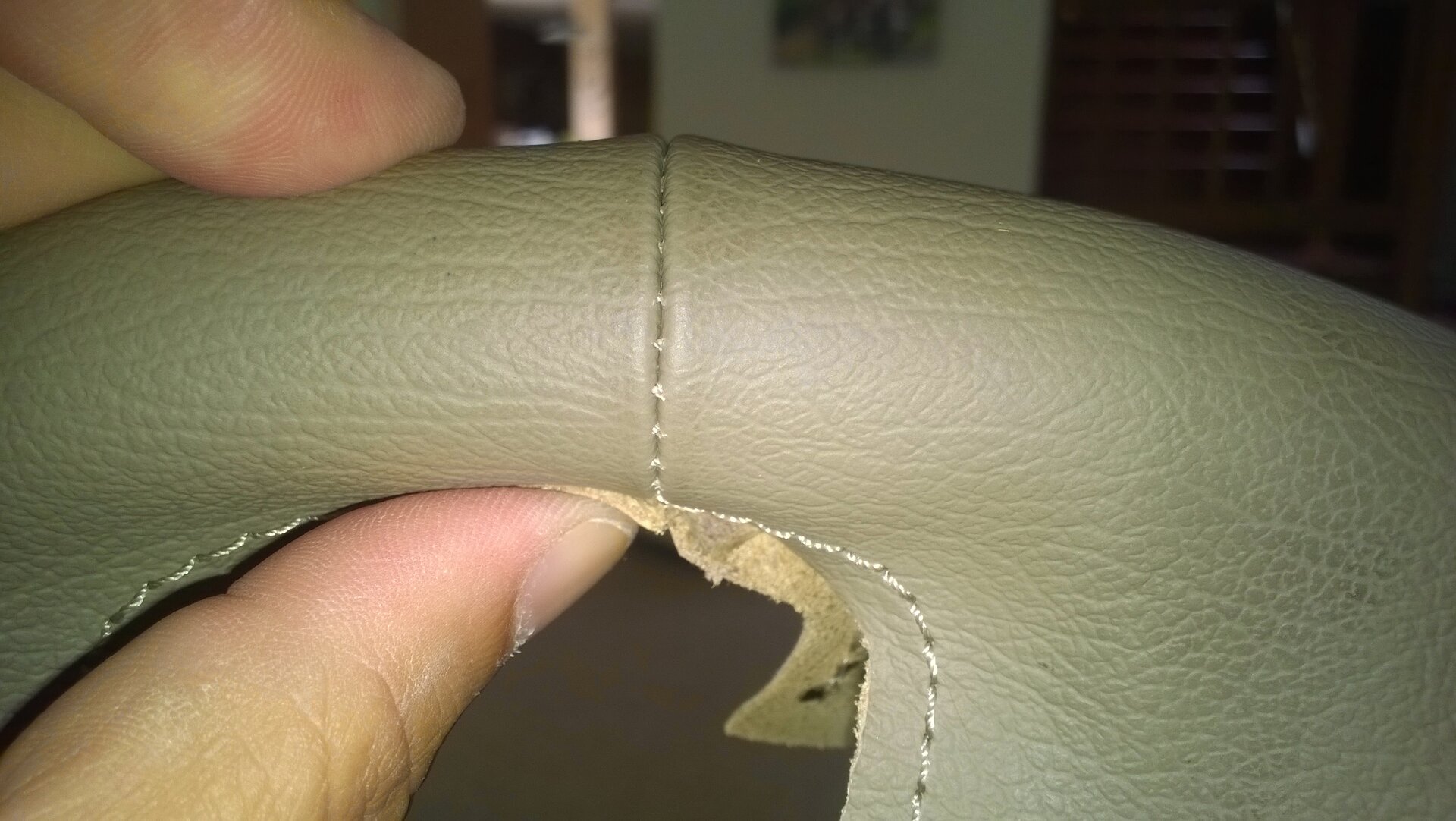

I have done something like that for my 21 yrs old (at that time in 2017) Camry that never had leather. The original wheel was coming apart, and the only replacement wheel still available shipped from Japan was of an awful gray color, so I needed to wrap it in something. Toyota wheel in leather was $800, local guy wanted $500 to wrap it, and RedlineGoods shift boots - https://www.redlinegoods.com/ wanted $129 (looks like the price is unchanged) for the cover with DYI install. The company is in the US but at that time the covers were made in Poland (maybe they still are) of high-quality EU leather (they have many kinds of leather to chose from). You can install it yourself (plenty of videos on YouTube) or at that time they also offered install option for $99. You shipped the wheel to their installer (at that time was in NY) and they installed the cover and shipped it back. It is now 7 years since I installed it and it still very nice, higher quality leather than many factory leather steering wheels. I love how it looks. It feels better to the touch than my LX wheel.
For me it was actually a bit more complicated than above as for whatever reasons the 97 US Camry had a thinner wheel than what RedLineGoods had in file. So, I sent my wheel to Poland for them to make a new template based on it. All went smooth and they were good to work and communicate with despite the geography.
Just checked and they have covers for LC.
Sorry, I do not have a picture of the cover installed on the wheel, just some pics from when I was working on it.
There are other products on amazon and ebay with DIY install. But the ones from RedLineGoods were of much better quality.

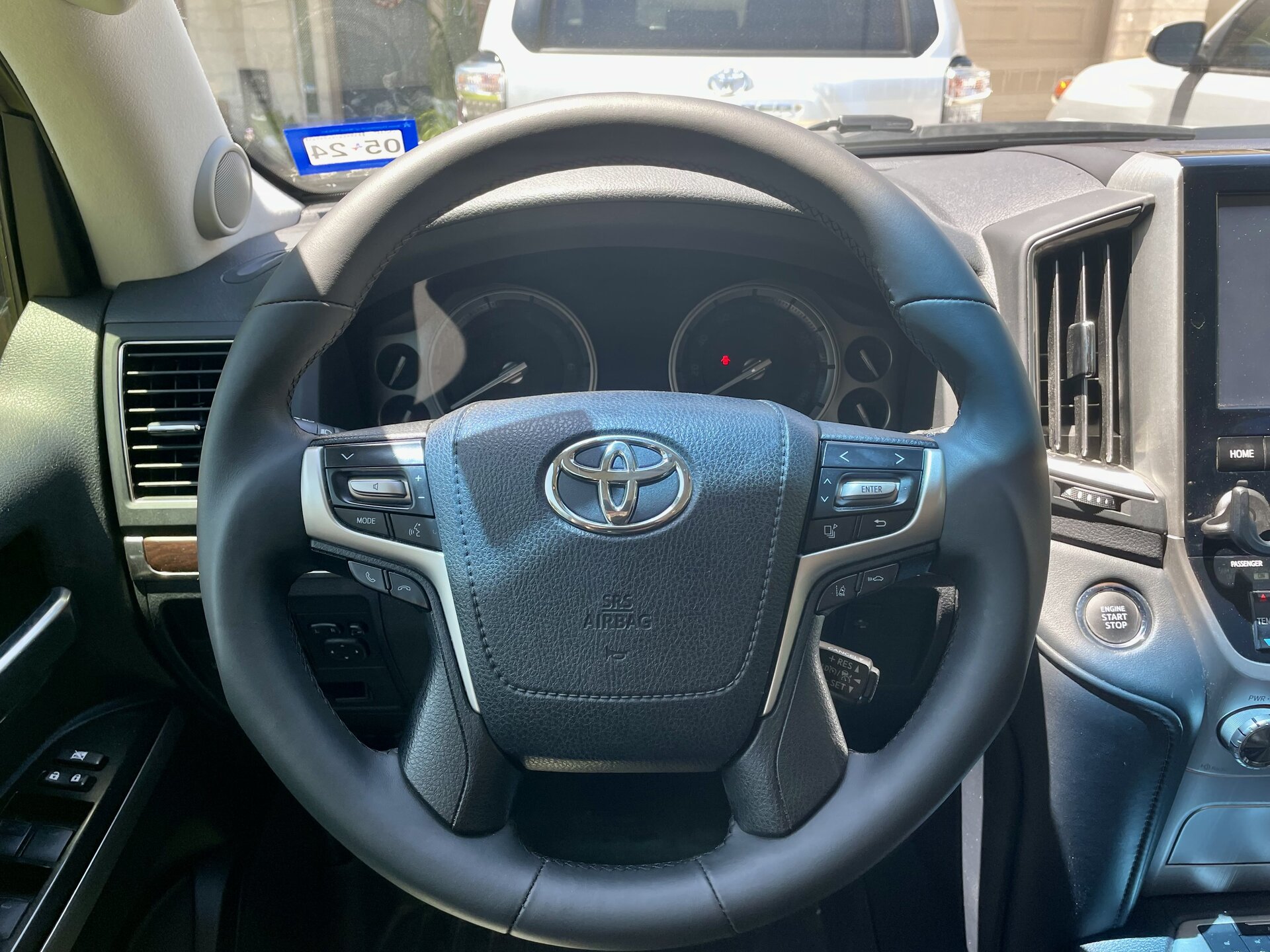

I went a different direction on our 2016, I ordered a PSV replacement steering wheel from Australia that eliminated the stupid wooden section on the top of the steering wheel. Super nice quality wheel and the center section and controls from the original wheel fit perfect.
FWIW - there is an OEM option that eliminates the wood. Steering Wheel Upgrade 16+ LC - https://forum.ih8mud.com/threads/steering-wheel-upgrade-16-lc.1307241/
Part: 45100-60A91-C0
