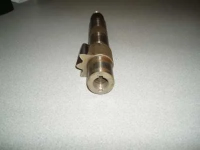

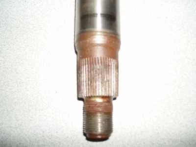

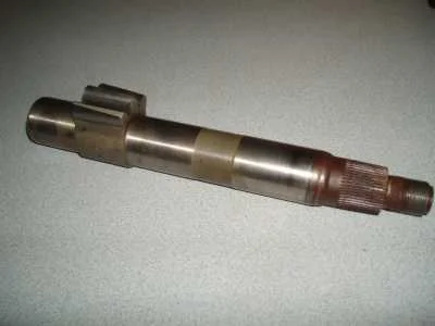

A couple of pics of the likely culprit
Has anybody found an aftermarket source for these as genuine prices start getting a bit over the top after the first two or three?
I hope for your sake it is only a bent draglink but I reckon it's probably the sector shaft.
:cheers:
edit; BTW in the first pic you can see the twisted splines causing the problem.
:cheers:
So, if this IS the culprit...would it be a big deal if I just straightened the wheel itself and kept on cruising or is there colateral damage that can occur?
