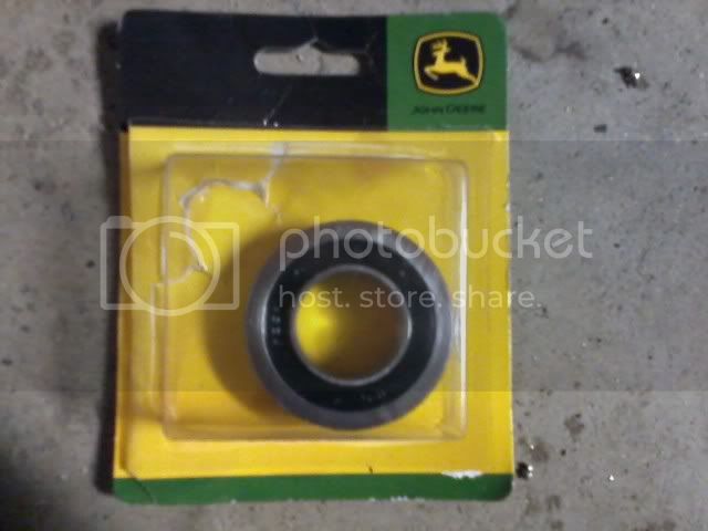

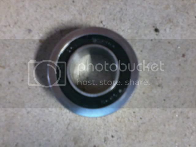

Putting a 60 p/s box into my FJ and I knew I needed a support bearing for the steering shaft. I know you can order them from some companies but I really was looking to get one sooner. A quick simple search on Google found a common bearing that is the same size.
John Deere Part number AM127304, front wheel bearing.
The John Deere place in town had 10 in stock, it was $8. I found this is the same bearing for a ton of lawn mowers, Cub Cadet, Toro, ect.

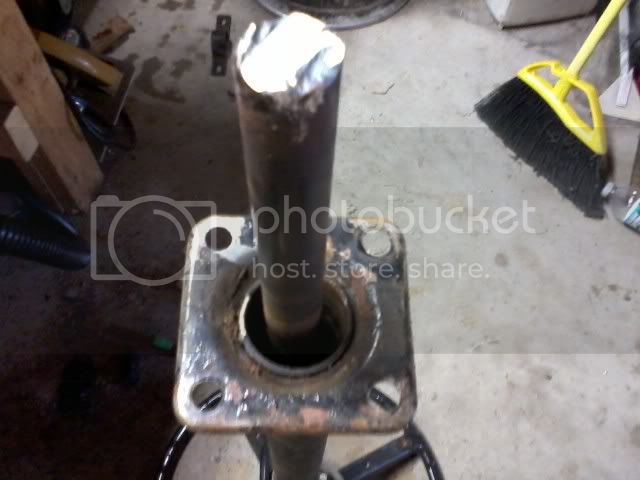

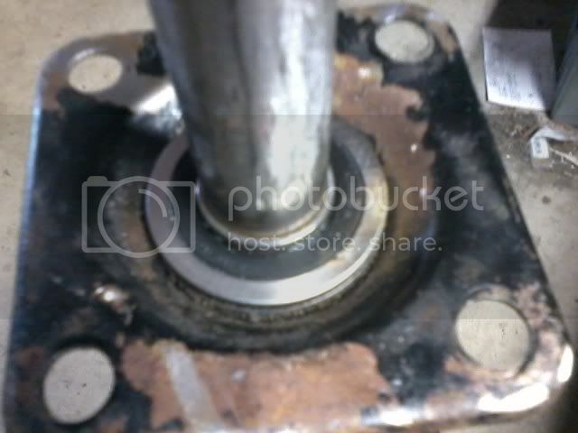

I picked up a bearing from a lawn mower--10 bucks at O'Reilly"s. Prime Line part number 7-04133. It's a pretty standard lawn mower sealed bearing. Its really nice because it will slide over the shaft, with the 20 thousandths sanding, and into the column tube. It has a flange on the outside that rests on the end of the tube.
Its probably the same bearing.

Just a word of caution. I am not sure what the requirements are to keep the shaft centered on 60 series power steering mod, so I cant comment there, but I would be careful about putting a bearing into the bottom of the stock steering tube. As all of you know, the steering shaft is one of those rare connection points between the body and the frame (via the steering box). As such, there are two "rigid" connection points. One is at the rag joint and the other is up at the bearing that is housed within the ignition switch assembly. This is by design, the foam "bushing" that is placed in the end of the steering tube allows for lateral movement that occurs when the tube and the frame. The rag joint also is a semi-rigid surface and can absorb some of this movement.
Here is the rub: when you put that bushing in the bottom of the tube, any movement is directed straight down (into the steering box) or up through the steering tube and into the ignition assembly....something will eventually have to give.
Food for thought. Whether it was US DOT mandated or reengineered by choice, there is a reason that the 81-84 shafts are ALL collapsible.
Loser is correct in pointing out that it is possible (common, even) to put together a steering column w/ no flex or slip, which is hard on components.
Pink is doing it right by using the bottom half of the FJ60 steering shaft with the factory slip yoke. That allows plenty of travel as the body and frame flex.
I'm in the planning stage of this conversion. For my '81, do I use this bearing on my shaft/firewall or am I needing a different column/shaft altogether?
NoeyR, looking on SOR I see that the steering column tubes are the same from '72 - 7/80, but are listed as a different part from 8/80 - 84. You might need to pull the column apart and measure the parts to see what dimension things are. I was glad I did because I was able to service the bearing at the top of the column at that time, and it made the steering turn nice and smooth. And it wasn't really that big of a job.
The specs on the bearing in the post are:
.751" Center bore
1.38" Outside dia.

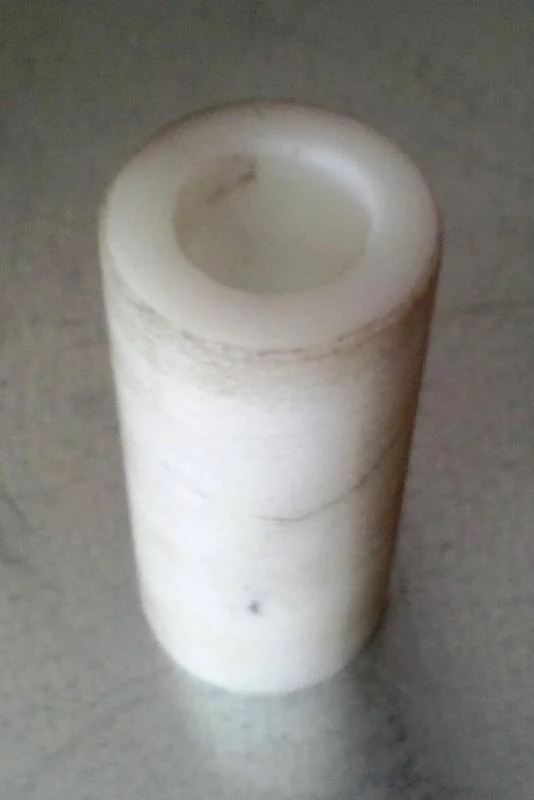

The steering shaft in my '76 had to have been 19mm (.748"), because a 3/4" hole through a delrin plastic "bushing" that was turned down on a lathe to fit the inside of the steering tube was my solution at the time.
I haven't had any problems with my install, but I might have to pick one of these bearings up. I don't know how they are holding them in the end of the tube, but I would find a 3/4" collar with a set screw to do the job.
Good luck with your install.
