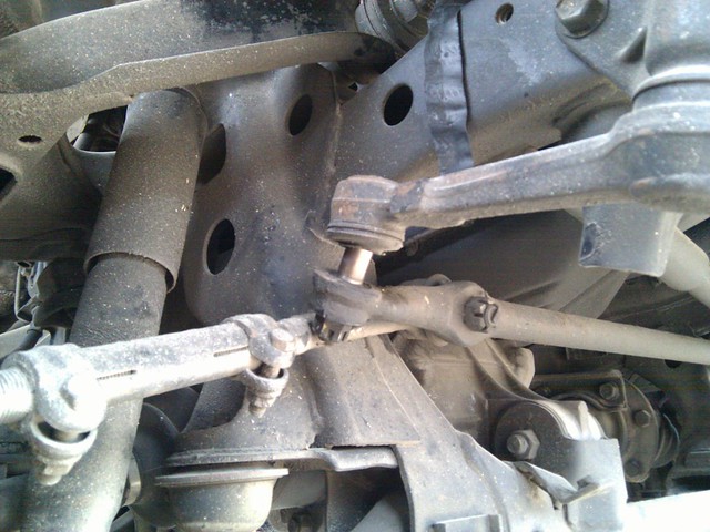

I have noticed over the last week two that it sounds like my PS is going out. Well, while trying to do an ARB front bumper install (another thread), I noticed my tie rod end is separated from the relay rod. This is on the PS in front. Do I need a new end, relay rod or just bang/tighten it back on there?
TIA.
It all depends on what got worn in the process. Loose parts wear faster, and that hole may have gotten enlarged beyond usable. No, I don't know the limits...
Replace the idler arm! Consider yourself lucky it has not come apart yet. I recomend not driving it untill it is replaced.

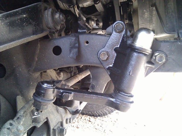

Closing the loop on this for others, the 2nd gen idler arm went on the 1st gen without hiccup. Torque for the 3 bolts is 70 ft/lbs and the castle nut is 43 ft/lbs. Pics below show the finished result as well as the part # from Autozone.
