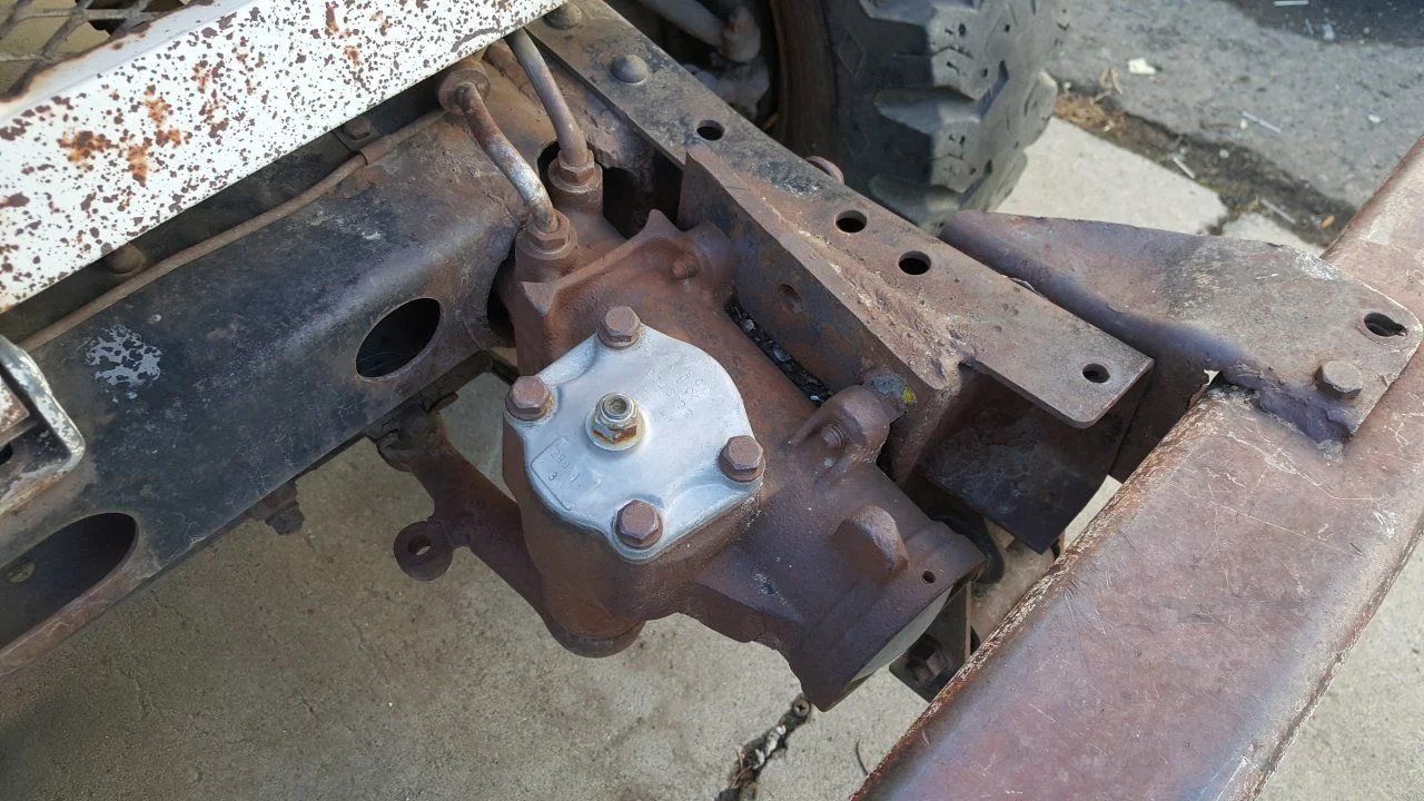

I am trying to figure out what parts I am going to need for my 1967 FJ45. The previous owner did what looks like a hack job of a power steering conversion, and I'd like to go back to Toyota manual steering. I've got a guy locally that has the column, wheel and steering box out of a '72 FJ40. I'm curious if that will work, and what else I will need?
I plan on taking the Saginaw box off the front frame and patching that up. Any help and advice would be greatly appreciated.
