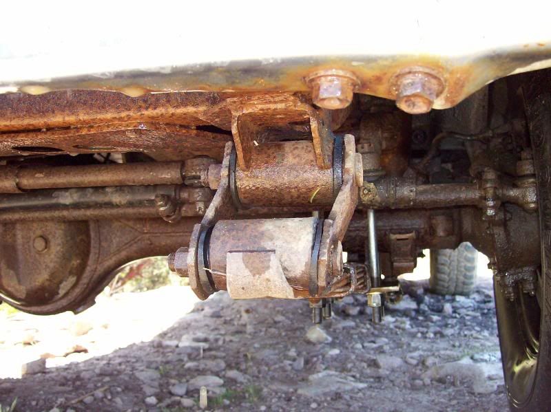

if I did it again I would do it this way minus the drag link.. still might..
I'm not clean on that pic .. but it's the tie rod front or rear of the axle ? ( need new glases ? :eek: )
In front with low steer and a big tie rod, that is the best pic there is of the steering.
I have wheeled with this Brian a handfull of times, and that thing works soooo well, reason to keep it low steer is the ablity to keep the truck lowlow and have a ton of uptravel without clearencing the frame.
now I see you have the drag link coneted to the tie rod at the middle ..

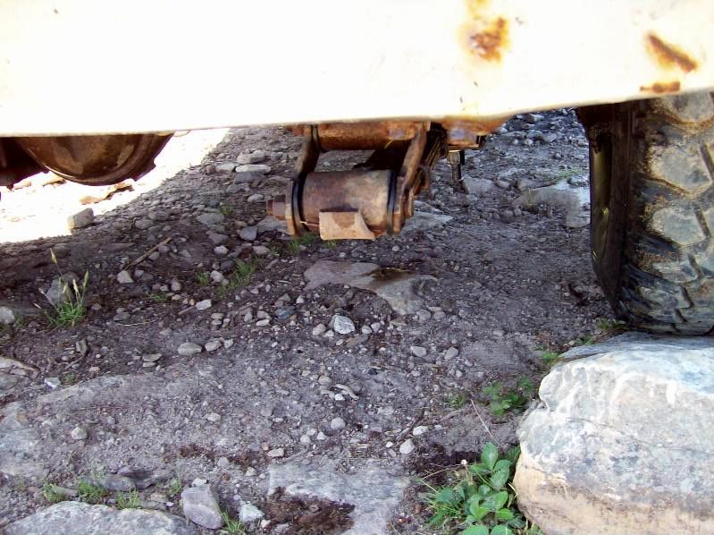

bent up my tie rods and shackles good on a rock so thats a 1 point for the hy steer above the leafs..
and i need to flip those damn u bolts up...
