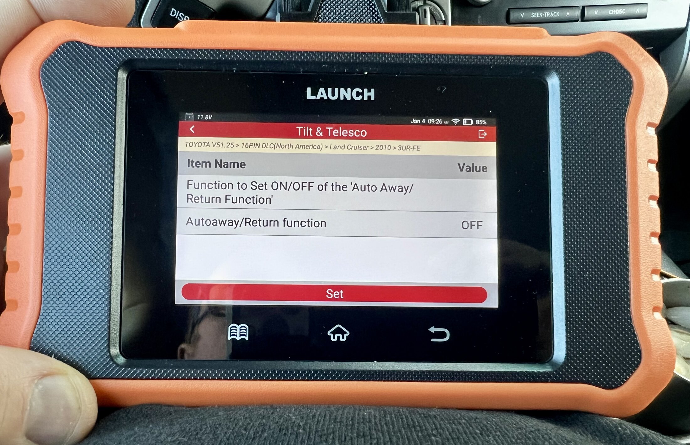

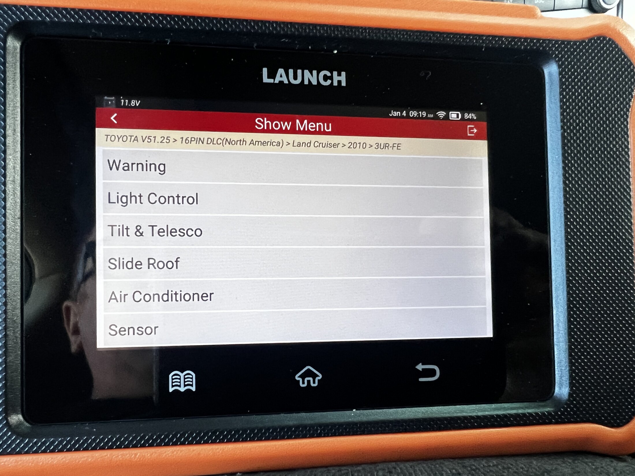

Although not the most intuitive reader out there, after a whole bunch of trial and error, I was able to get this to work.
Huge thanks to @misteracng for the heads up on this.
The more I messed with it, the more features I found.
This is quite the tool and for me a HUGE plus I don’t need a laptop, and can keep it in the truck.
Was able to disable the wheel as he described:
Sooooo

glad to help, in fact all the bi directional scanners for toyota/lexus will do pretty much all techstream functions that most people need. This is usually always more then carista, altough I think some of the phone app based are full featured as well like the Topdon unit. The reason I went with lauch is because I believe alot of the other companies software is based on launch software.
