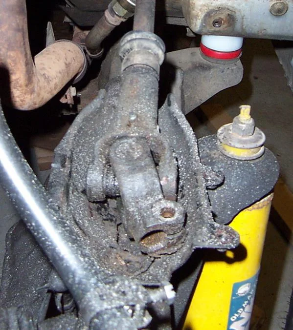

Stole this pic from NocalFJ60...

you shouldnt have to unbolt any of that to grease the shaft heartworm,their should be a grease nipple on the shaft.
cheers goldchaser

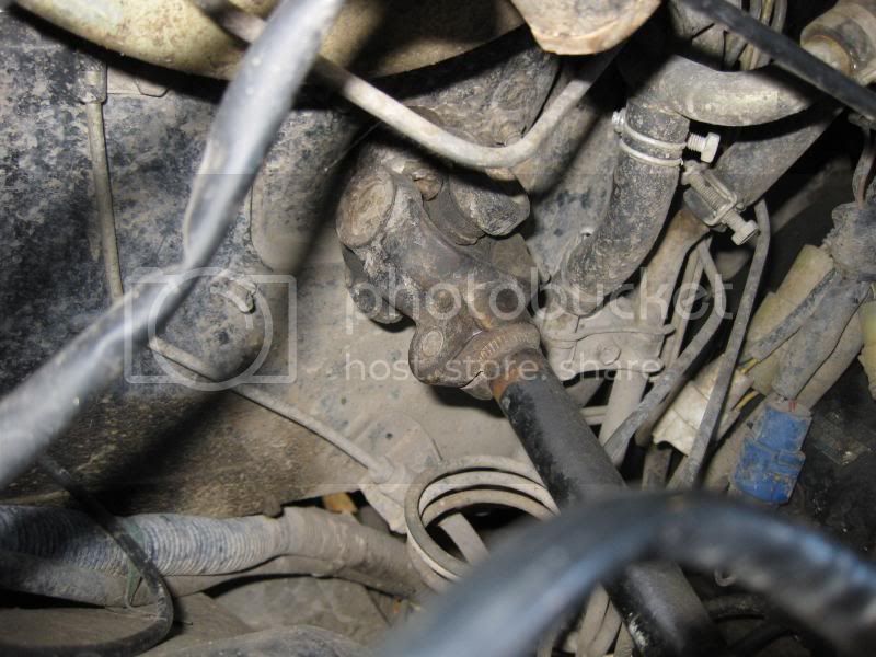

I have identified this also as the clunk in my 60. Mine is an 85 and has tilt steering. The clunck is in this uni:
I cannot see any grease nipples on the shaft or uni. What exactly am I looking to do here? Am I to undo the clamp on the bottom uni (steerbox end) remove the shaft and grease it up like that? Any info and pics would be great!!

Joel,
The grease nipple is down the other end of the shaft near the steering box.
There's a pressed metal cover which needs to be removed so you can get to the nipple. Just a couple of bolts (3 or 4) to get the top part of the cover off.
That will allow you to grease the spline where most of the clunk usually comes from.
It often feels as though the clunk is in that uni in your photo but usually the clunk is at the spline which is dry, and the jarr can travel right along the shaft and right up into the uni joint.
