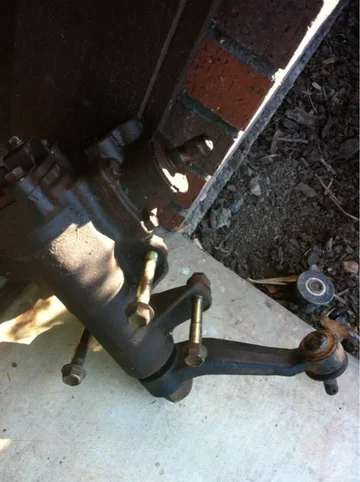

Steering box for 55 lets bring it togather
I have FJ60 power steering box, GM power steering pump, stock steering column, I am sprung under with 4" OME springs.
Could use both
