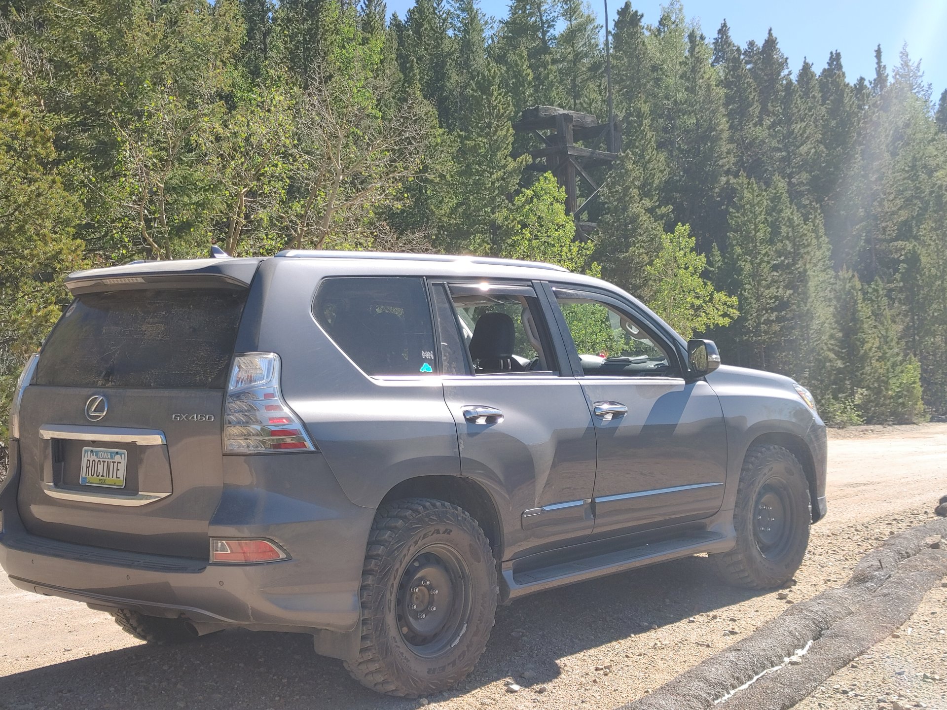

Since I haven’t seen many around, I thought it might help to post some pics with my GX460 on 17” FJ Cruiser steelies. Love them.
Looks great! Now to see if we can get 16" Tacoma steelies to clear the calipers. Anyone tried? I'm always looking for a cheap single spare one on CL/Offerup, but don't wanna spend $75-$100 for a test fit...

Oh, I agree. I’d rather have 16”, too, but wanted something that I knew would fit. Just went through a fitment nightmare with some Borbets on a 944 Turbo, so didn’t want to mess with that again.
This looks great, I'm trying to get some 17 inch steelies right now on my 2012 GX and it has been an abject nightmare. Did you have to do anything to make these fit, like spacers, special bolts, voodoo etc? Because the ProComp and Vision steel wheels Ive tried so far are hitting the calipers every time
What size tires are you running in that pic? Stock suspension I assume? I've got a set of 17" fj steelies I'm about to install.
Goodyear Wrangler MT/R in 33x10.5R17 which is the SAE equivalent of 255/80R17. I love them for the most part.

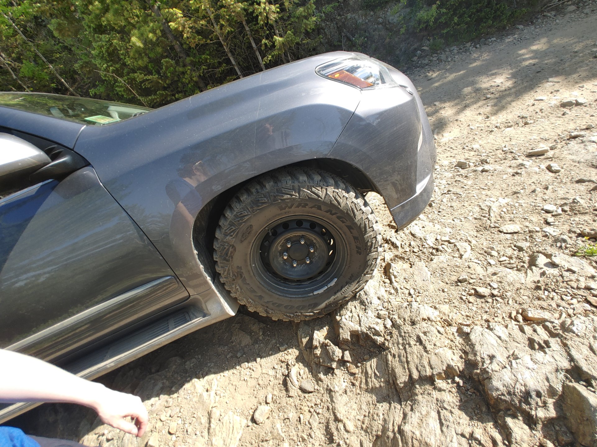

I realized i never came back to this thread. These are my fj steelies.
How much lift and did you get new upper control arms?
No lift and no uca rub. Totally stock with front and rear part of the front wheel well liner pushed as far back as possible. Stock offset with skinny tire allows you to max tire diameter. But dont even bother trying to put it in the spare location. I ratchet strapped it down and put my traction boards on top of the spare woth towels on them for a shelf for commuting.
