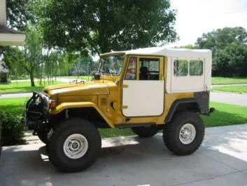

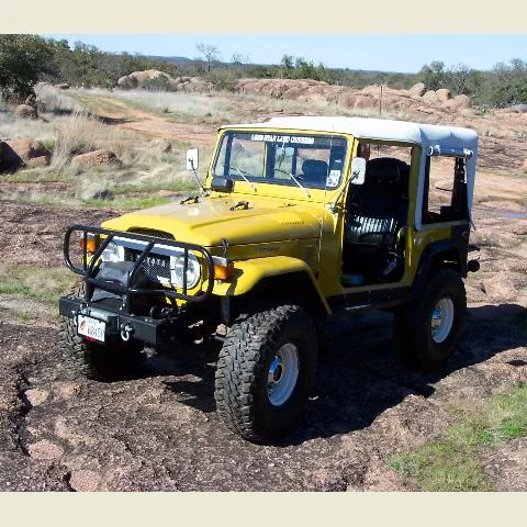

Several have had stock wheels widened at Stockton (15x8, 15x10) and I've seen one set reworked by Stockton into a 16x8. On the 15x8 was a set of 37x12.50 Goodyear MTRs. Widening the stock wheels retains the clips and hubcaps.
Here is a the Cruiser I referenced above with 15x8" OEM steelies (widened by Stockton Wheel in California) running 37x12.50 Goodyear MTRs.
Hot dam!!! Do you have to send them wheels to widen or just order some to specs you want?
Ship them to Stockton. They cut the centers out and re weld them into new barrels. Any width, any backspace. They can even size up (+1) to a 16", which would be the way to go.
hmmm thats gonna get pricey all that shipping. Ill keep looking at options
How do hubcaps retain the "stock look" when on a widened wheel mounted with 37" tires?
Wasn’t my truck but it had a spring-over lift with very flat springs...
As far as I know, wheels retained stock backspacing and offset...just widened from 5.5” to 8”.
Wheels were built by Stockton for David Reljac ...not sure if he is still around
@kcsmithson owned the truck after Reljac...maybe he will answer up.

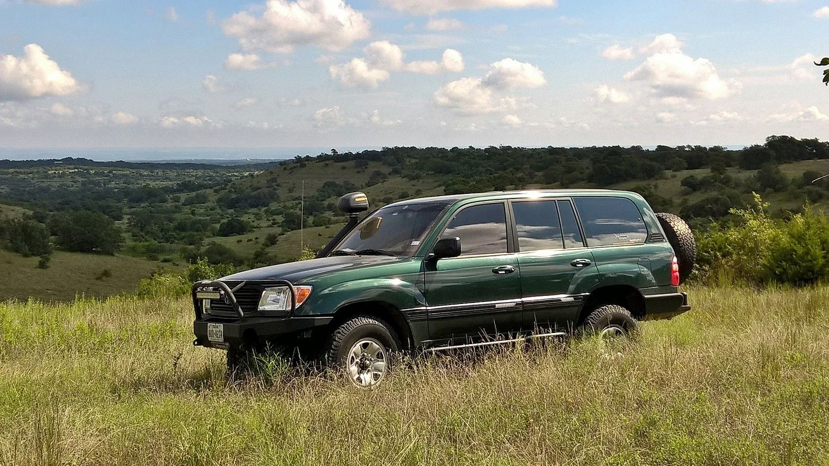

Ha! I forgot Henry had the wheels made. @Exiled has been on mud , lately, applying his penchant for OEM Toyota Steelies to his awesome 100 Series here:
If he doesn’t post-up here, just shoot him a DM.
