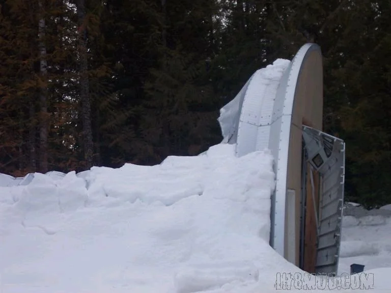

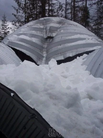

    I put up a pioneer steel. Some things to consider. IF you're in a snow belt, the snow will not slide off the peak. Sealing the ribs into the channel is a daunting if not impossible task. With the 1000's of bolts, some are certain to leak. How do you insulate it (if necessary). How do you wire it? Why a steel over a stick built?
    In all honesty, I should have done a pole building kit the first time. WAY easier, just as inexpensive, and way stronger. If you want anything else, just let me know. :cheers:

    Yes, but I found out what a great insurance company I have. They treated me extremely well! :cheers:

    Thats makes it better, Going Pionner again? Was it setup with the Wrong Snow load number?

    Nope, already rebuilt stick frame. That building was rated to 75 lbs/ft and I've since met another guy whose arch building went down and his was rated at 120. Code for my area is 65 lbs/ft. My new building is on the same 2' high stemwalls from the steel structure. It has 14' walls (total) in the 30 X 30 shop portion and the back 10' is a bathroom, man room (storing all my hunting crap, reloading stuff, etc), with loft storage over the top of all that.
    Here's the original thread.
    https://forum.ih8mud.com/chit-chat-section/209962-my-shop-collapsed-last-night.html
    No hijack intended, just letting you know what can happen. :cheers:

    Every county has a building code for a reason, the collapsed building was not able to withstand all that weight. If the building had a steeper roof the snow would've slid off, unfortunately a Quonset style building cannot be designed like a straight wall. A custom steel building should do the job, I used MBMI once they helped me build and they exceeded my county codes.
