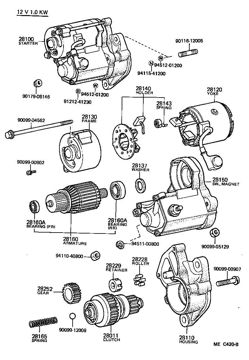

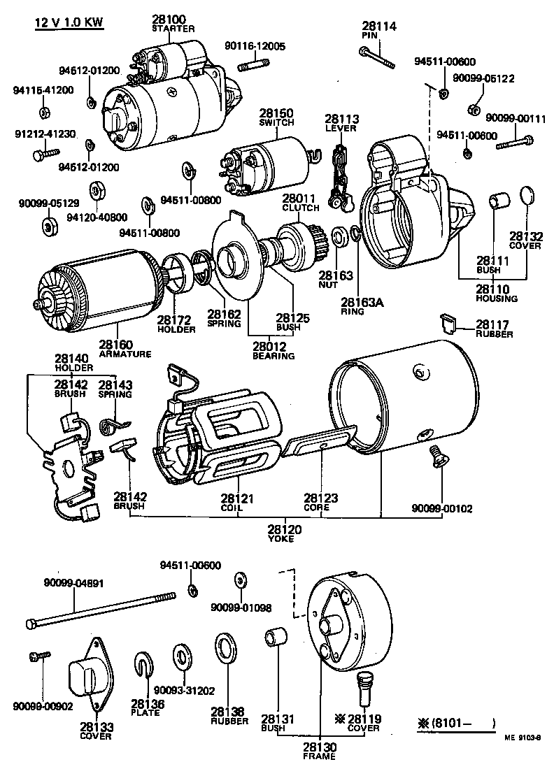

OK, I think I understand what's going on.
The starter on the left in the image below is the Direct Drive starter (PN 28100-60042 which is superseded by PN 28100-60090-84) for the (8008-8206)2F.
The starter on the right is the Gear Reduction starter (PN 28100-60070-84) for the for the (8206-8708)2F.
The guys in the 40 & 45 section are upgrading from the old Direct Drive starters to the later FJ60 Gear Reduction starters (see links in post below).
Given that my 12/1981 starter is Direct Drive starter, I believe it would be an upgrade (and save me alot of stress on cold winter start-ups) to switch to the Gear Reduction starter...but haven't run across any posts on early model FJ60s doing this...just the 4X guys...
