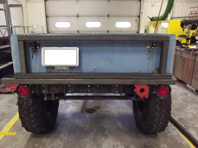

so I started working on the trailer for the Oct trip. got a lot done in the last 2 days. the swing out rear will have a jerry can holder and a storage box. the inside of it will have a fold down table. here's some mock up pics:
with the bumper mocked up too-
attachment.php
with the bumper part welded in and a spacer for the swing out part-
attachment.php

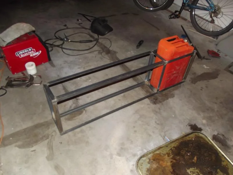

and here's the rack part to be added to the swing out. jerry can mount on the right, other part is the top of the box storage.

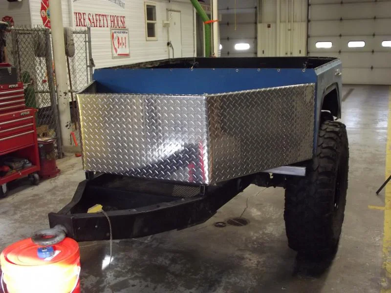

I've got more diamond plate than I know what to do with now. guess I'll continue with the current plan and box it in with diamond plate. front tool box will be diamond plate. it is still off being sheared and bent. more work to come Saturday (and pics).
got some work done yesterday. bent the end mounts and mocked it up. floor is cut and just needs final trim/fitting.

I got the floor in today, on 3 hours of sleep. tax payers got their moneys worth from me last night... pics maybe tomorrow.
