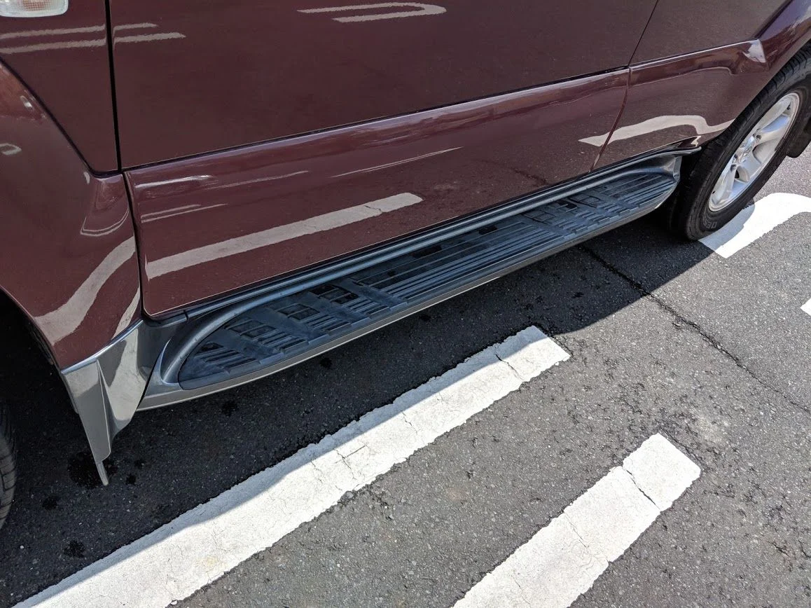

If any of you guys have the OEM side steps available, I'd love to swap them with my Prado sides or just buy them off you.
(I'm not going too crazy with this thing and the GX wasn't sold here so might as well play up the "LEXUS" factor...the Prado sides aren't lit and are more sporty looking)
