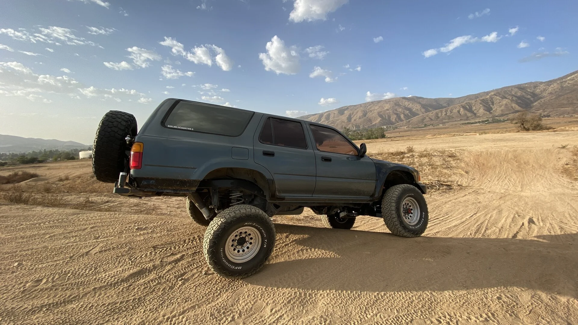

Heres my s***box
It’s long travel with big shocks front and rear with aftermarket springs.
