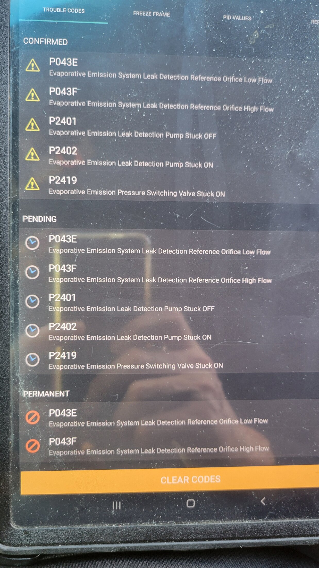

For me, the fix was replacing the charcoal canister.
But I got to this only after I had tried the simpler/cheaper fixes: new gas cap and replacing the purge valve.
Thanks. Yeah I was thinking that was the route. Changed it a few years ago chasing the boiling fuel/"dad it's smells like gas in the truck" gremlin.
I left off one other quick potential fix: changing the little air filter that’s behind the wheel well if you have an LRA fuel tank. That seems to solve the codes for a lot of people.
(You won’t have this filter if your fuel tank is still stock)
Speaking of evap codes...I finally got em just this past week, although the boiling fuel first appeared years ago. What's the "fix" if any other than clearing them with my reader?
As for fix…none is known.
-Toyota will gladly throw $750 charcoal canisters in, but no more than two or three weeks after I threw in a brand, new charcoal canister, my codes returned, and I went right back to clearing codes with an OBD2.
It’s a regular routine for me for 6+ years if not more… So much so that I permanently mounted a code reset device with an in-line power switch.
I’ve mentioned this before, but EVA codes can actually be cleared even while the car is on, running, and driving. No effect of clearing codes on the fly like that… At least for these gas related evap codes.
Thanks my friend. As you suggested before LCDC I made the tablet with the reader/monitor app a permanent fixture so when they popped up this past week on a trip it was easy peasy to reset.
I had same results when I changed canisters for the fuel smell...couple weeks and it was back.

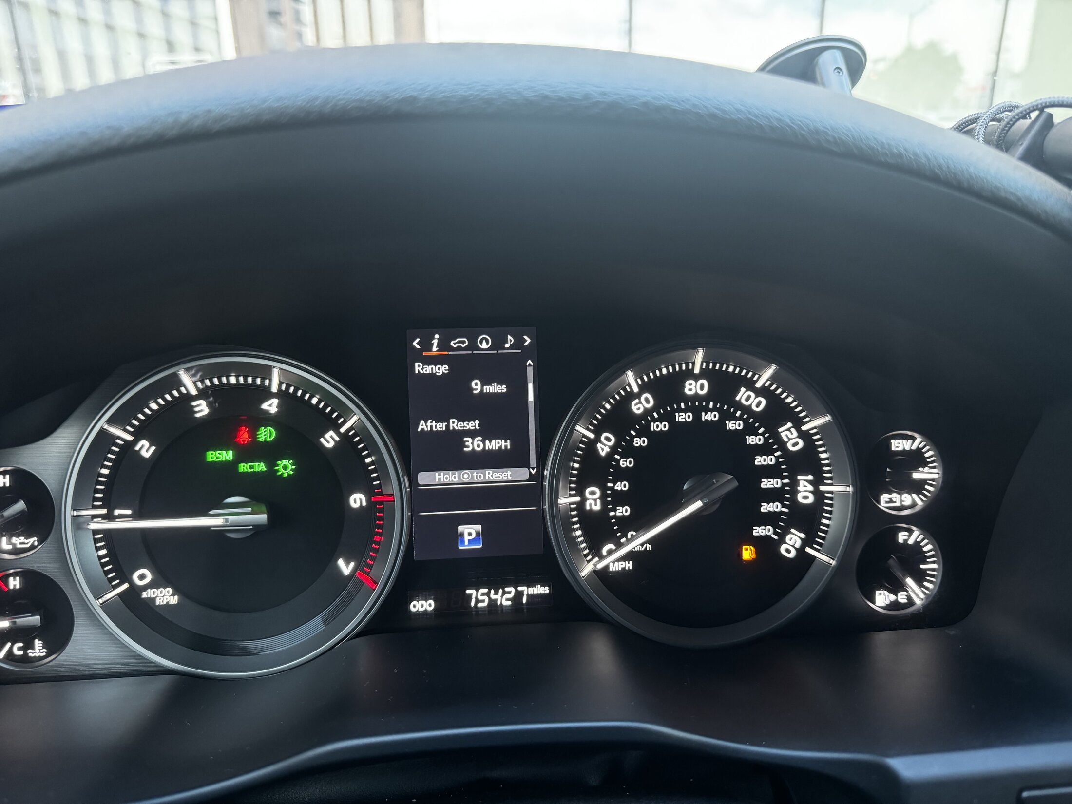

Mine generally quotes 0 when the light turns on.
Mine came on today with 9 miles of range.
But I think that range calculation employs a MPG since the last fill-up, or something, and recently my MPG is 10mpg or so since it’s been short drives around town.
