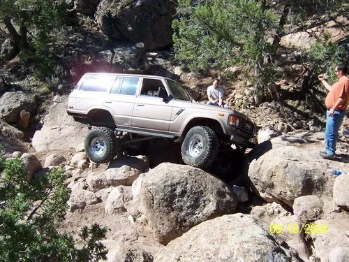

Been sprung over for about a year and half. Handles well with the front turned. I was passing most vehicles at 75 mph last time I went through the Virgin River Gorge on I-15, very stable.
Hey John-Your truck looks great since I last saw it at Cruise Moab 2003! Are those the 35" tires that you won in the raffle? Good poser shot anyway-where was the picture taken? I want to go there.

Those are the same tires, they have taken a beating since then. This was a joint run with SNLC and Wasatch Cruisers to Cedar City with Henry Brimmer. More pics are on our site at http://www.snlc.org/pictures/cedar city 9-18-04/cedarcity.html

I've driven with & without the sway bar. you can set your shocks much softer & get a much better ride with the sway bar connected. a sway bar will keep the body from rolling side to side of giving you death sway on the road w/ softer shocks.
I keep my sway bar connected full time & it does NOT limit flex. I dotched my disconnects a while ago since they are a total hastle.
here is the flex I get w/ the bar still connected on the front:
attachment.php
it'll droop more than that too! I'm a firm believer in sway bars for on road & even fast offroad driving.

What spring setup is that? Looks like great flex!

OME mediums with some leaves swapped around here and there. Definately will run something bigger when the 35s wear out.

are those stock springs? OME? What gears are you running?

Deja vu, OME Mediums, 4.56s, Detroit rear, Lockright front, no swaybars, cut and turned, stock tran/tfr :( , new driveshafts, Allpro crossover steering, F250 shock towers RS9000s front, Doestch Tech rears with custom mounts, 1.5" wheel spacers. Thats about it.
