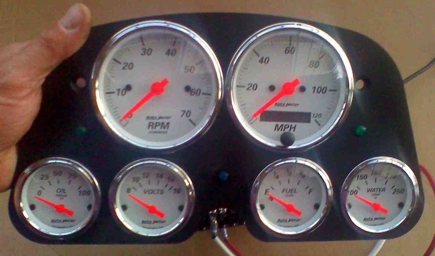

I am looking at the Trail Candy instument panels. May even get a Tach too, as my car is already wired for one. Might look something like this:
