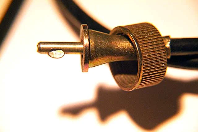

I've had a cable twist off and break inside the housing. Be careful about buying new cables: not all screw-ins are the same. The metal receiver speedometers are different threads from the plastic ones are different from the clipons. I know that the cable Mark's off road sells fits the metal recepticals.

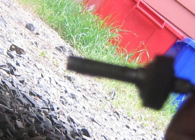

My cable housing is kinked and not in the greatest condition. The cable its self is still intact. However, the end that goes into the T/C looks to be in bad shape. There is a picture but it is blurry. The notch on the cable looks worn down and the cable will slide into the T/C even when it isn't in the correct position.
Yes, this might seem obvious, but is the notch on a new cable more pronounced than the one in the picture? I'm able to spend money on a cable, but only want to do that if you guys concur that is the problem.

Wow man, talk about blurry pic man.
If the drill trick works then chances are good that it is the cable. It should have a little nub that is on the end for going in only one way.

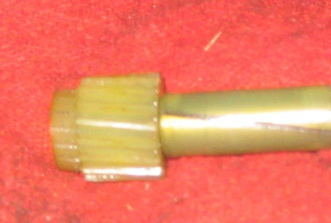

just a thought, if the end into the transfer is messed up would the plastic driver piece in the transfer also be screwed up??
Here is a pic of my gear.
The teeth are flat on top and equal all around the gear.
Question: Are the teeth on the gear supposed to go all the way to the end of the gear? Does my gear look to be in good working order? It is about $26 for a new gear and I would prefer not to buy one if this looks to be in good shape.
Thanks for looking
Dave
Pic's a little blurry Dave, but it doesn't look dished enough to worry about. As long as the splines look even across the length, you're good to go.;)
The part on the end is supposed to look like that.

As Mark said, your gear looks just fine in the kinda blurry pic.
What does the inside of the other end of the same piece look like? Should be round with a slot in it for where the right cable to only fit in one way.
