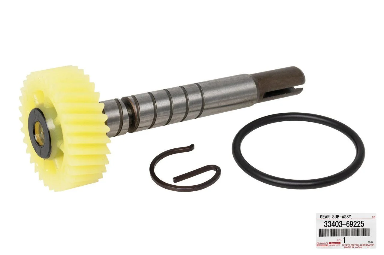

Has anyone installed a speedometer adapter for bigger tires? I'm trying to figure out which one to buy.
Looks like this:
We’ve done both the adapters as well as modified the drive/driven gear in the Tcase/speedo output to modify speed.
Just remember you'll start putting more kms on your rig if you correct the speed... well kms showing on the odo anyway
Could you hit me with some some part numbers if you don't mind? I'm going to buy an assortment of driven gears.
I'm traveling out of the country for a bit. Hit me up in a few weeks.
