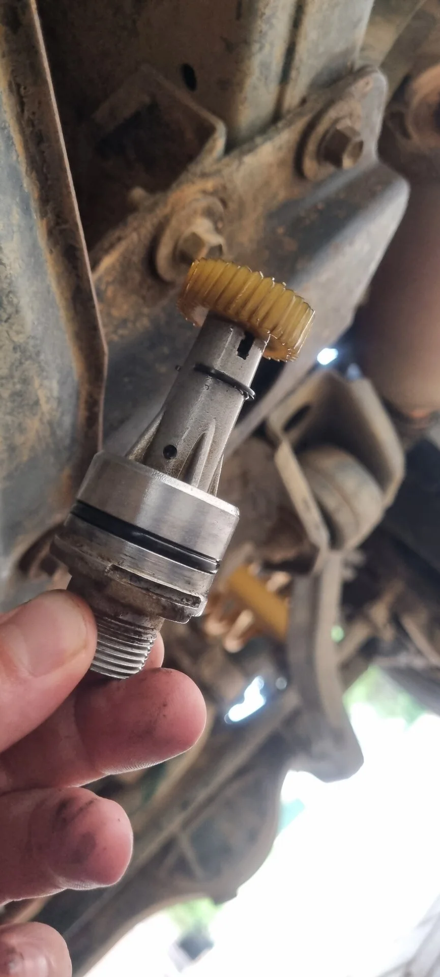

IVE REPLACED THE SPEED SENSOR AND INSPECTED THE 3 WIRES COMING OUT OF THE SPEED SENSOR AND LOOKS OK. ALL OTHER INSTRUMENTS WORK FINE.

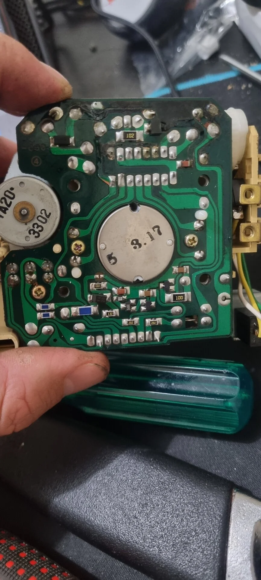

Yeah I'll take out the dash and check the board on the cluster see if anything burnt out or not looking to good. Both speed sensors are doing the exactly same thing. Cheers mate will keep you update most likely do it all tomorrow morning..

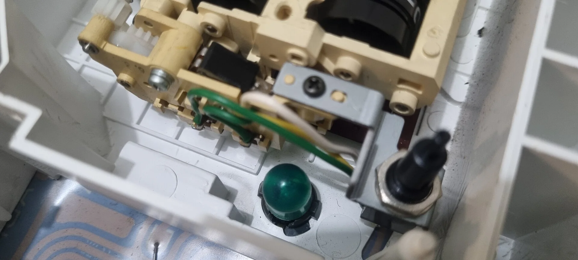

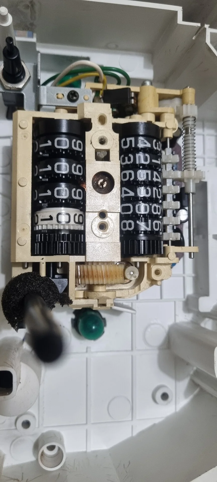

Here's it out couldn't wait till morning. Everything looks fine im really stumped now.

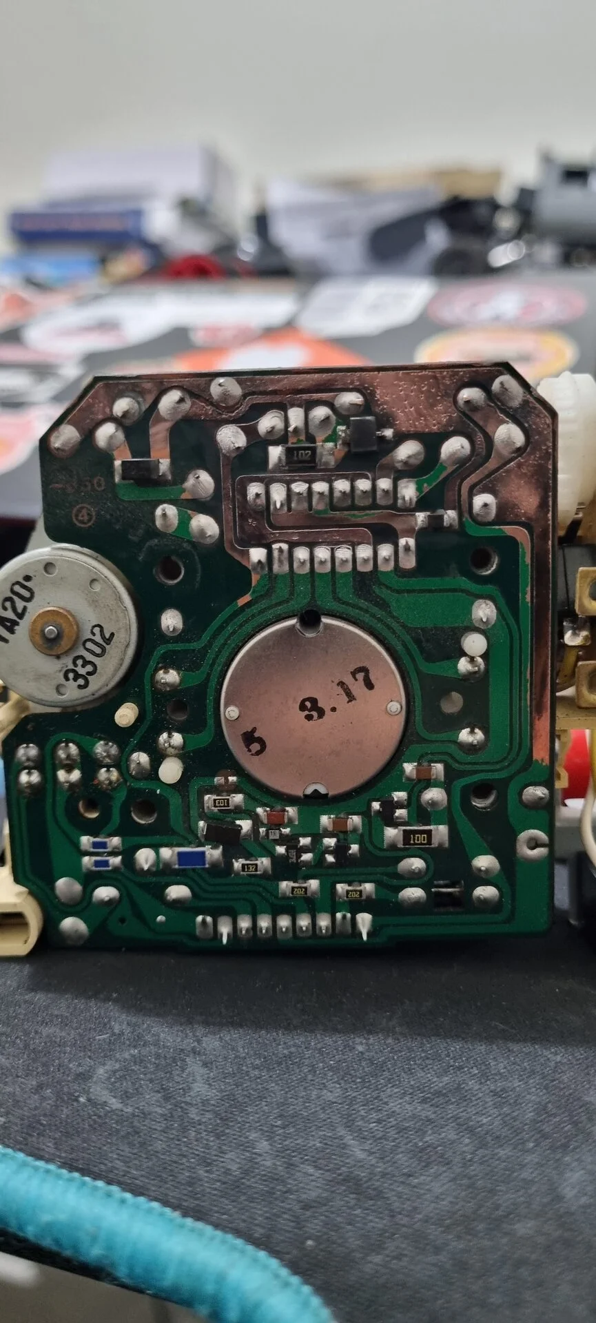

Jumped the circuit's the speed now reads over 60 but is still starting at 60 its almost like 60 is its 0 point now. I'm truly stumped.

I think I'll take you up on your offer mate I've narrowed it right down to the speedo being the issue.
