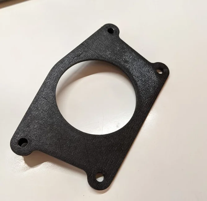

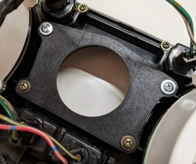

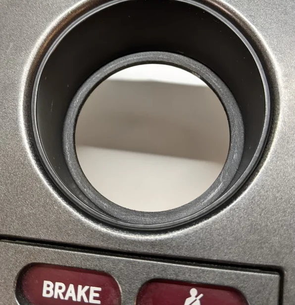

I recently got a Speedhut tach that I am planning on installing in my LS swapped 60. Needed a mount to hold it in so I designed and 3d printed this bracket for the stock location. Figured I would post and share the file here in case anyone else could use it. STL file attached here and link to the thingiverse page below. I do not have designs for the quad gauge or the speedo
www.thingiverse.com
FJ60 FJ62 aftermarket tach bracket by BuckBuckPrint
This is a bracket that allows you to install a speedhut 2 1/16" tach gauge into the gauge cluster of a FJ60 or FJ62 land cruiser. Center hole is 53mm if I remember correctly and should allow for installation of similar size gauges. It will require 2 longer screws for the top of the bracket which...
