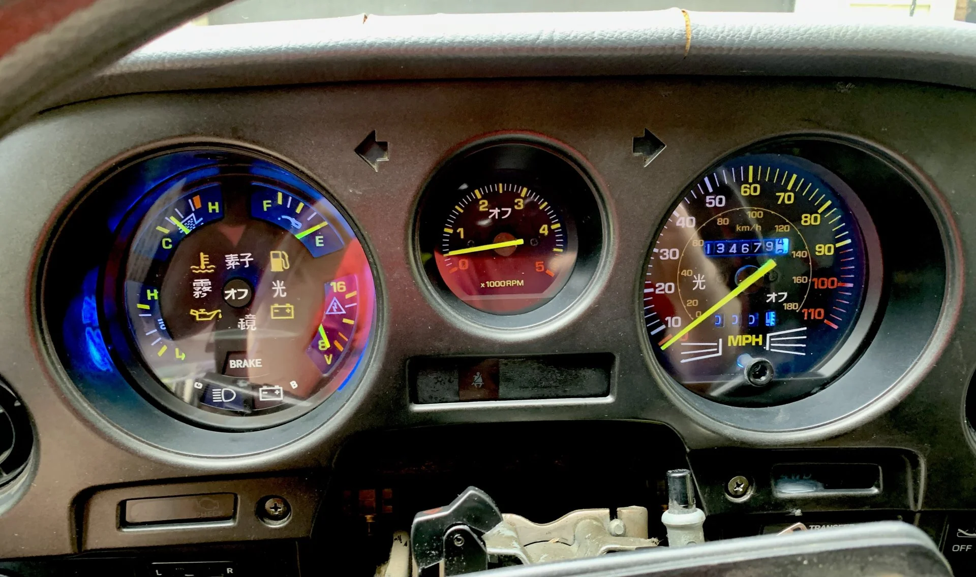

Hi everyone!
I am from Gabon ( in the central region of Africa). I recently got interested in collecting a few 60 series, diesel so far (2H, 12H-T engines).
I have driven a couple of 2Hs and 12H-Ts at full speed, or at least I pushed them as fast as I could on the highway, but I have noticed, they would very rarely go beyond 100 Kmh (62.14 mph).
I must confess the 12H-T engines had the turbo removed by the previous owners, but still, they were able to go up to 70/80 mph sometimes, after much effort.
Well, I know that as old-school (underpowered-as-per-modern standards) engines, they are slow to get up to speed, but
1) why does the needle on the speedo always seems to stabilize around 60/70/80 mph while the dial ( I guess that is the right name) indicates up to 100 (2H) or 110 (12-T)?
2) Is it because most of these engines have more or less 300,000 mileage on the clock (plus probably poor maintenance history), and could they do better after a rebuild or turbo install?
3) Or is it that in some parts of the world these cars came with factory speed-limitation "modifications" that a mechanic can or cannot fix? (I saw a few vids on Youtube where these engines could a bit more easily go beyond 80 mph.
Thanks in advance for your enlightenment
Regards
NNB

They weren't originally designed to travel at modern highway speeds. However, if you give them some extra horsepower (increase boost and fuel) they will be able to go faster. A 12h-t without a turbo is just a weird 2H...put a turbo back on it.

Gearing people. Turbo or not. Run 4.88’s and you will go 85-90 k max. Stick a set
of 3.73 gears in there and maybe 140 k. Also, overdrive or not. Stock 1:1 or 1:73 overdrive?
overdrive allows more speed, taller gearing.

I can pretty much bury the speedometer needle on my 12HT 5 speed HJ61 with 3.70 gears and 255 85s if I wanted to.
140 Kph is very easy, and over 160 kph is something it's not designed for and I would say "do not do this!".
