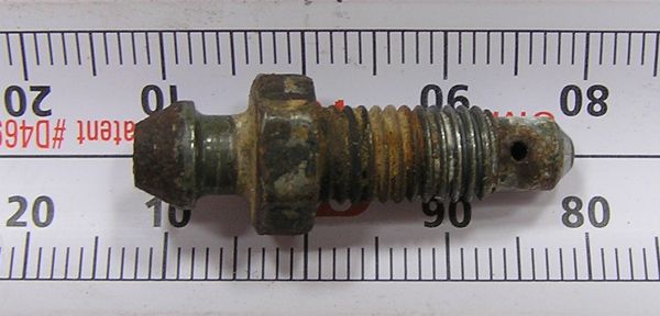

Just wanted to definitively post up the LSPV bleeder valve size to help others not waste any time.
This was correctly nailed back in '03 (https://forum.ih8mud.com/showthread.php?t=1671) but not explicitly stated, so here goes.
The four corners all get the SB1010.
The LSPV is M-7 x 1.0 and is just over 30-mm so SB7100S is the correct one to get.
:cheers:

Definitely do not put it in and crank it down expecting a solid resistance when it hits bottom. I put mine in and immediately twisted it right off. Treat that one gentle as it is quite a bit smaller than the others.

Fyi, the earls solo bleeders are much better. I recently used them for my 80 and they worked great. On other vehicles I have use the speed bleeder type & the earls type and the earls just work better. I followed the advice of the OP and ordered the SB7100S for the lspv because I could find the earls in a m7 size. Op thanks for the tip but that is the wrong one, it is too short. It needs to be longer. It bottomed out in the lspv housing and I could not tighten it all the way, resulting in it leaking. Just wanted to update this thread for peeps searching.
***Update the ones you need for the lspv are "speed bleeder" part # SB7100 or
Earls "solo bleed" part # 280025ERL
