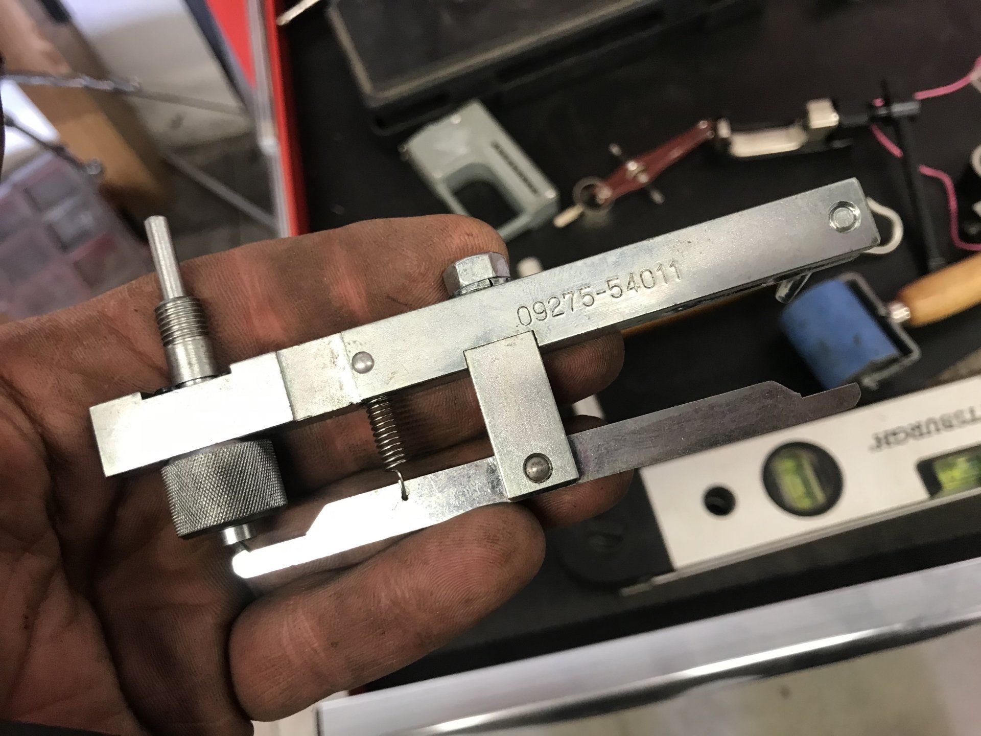

Does anyone can let me know where can I find the tool below?
09275 54011 Plunger Stroke Measuring Tool
09992 00024 Cylinder Compression Check Gauge Set
09992 00400
Thanks.
I bought these of ebay. I have used the valve shim tool, it worked great. Haven't tried the pump timing tool but quality looks good.
So if it is the FST
You need a special dial gauge, this is what I use.
It all about the shaft on the dial gauge and it fitting the FST. It’s a kind of uncommon size in the USA, 7 or 8mm if I recall right.

So if it is the FST
Cheers
Dude thanks for posting this!!! I need to find a dial indicator that fits and measured my tool and its 8mm
