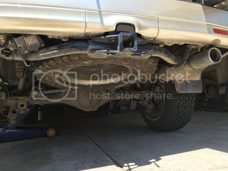

It fits on the 4Runner just fine. Not sure if the type of hitch that you have makes a difference for fitment.
I don't know. It's some under the bumper hitch like what I see a lot of Gx's have. I figure it's protecting my bumper cover when I slide my backside on the trail. So I had planned on keeping it. It's not that low. But it is right below the bumper cover.
Your right. It fits fine. A little tighter. I got a KO2 same as all the others as my spare. Makes zero sense to risk a week of 4wheelin driving around with out a proper spare. Now that i know I like the KO2's I don't mind paying. In the end I get the same mileage per tire on 4 as I do on 5. Just need to do a 5 tire rotation.
