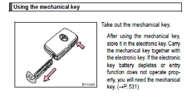

:meh:Have a spare mechanical key cut, it will open the doors.

Is the smart key diagram from a 200 series? I had no idea the truck had a keyhole... Where is the keyhole located?
You can use the mechanical key to enter the car but you need to place the keyfob immediately next to the ignition button to start the vehicle (still need to push the ignition button). I do not know of a way to start the vehicle only with the mechanical key.
Yes, there is a keyhole on the driver's door only.
Correct -- there is no key to start the vehicle. What you need to do is hold the transmitter right up against the start button. Even if the transmitter broke, this still "should" work. It's a passive RFID device at that point. If the actual start button somehow broke, however, you're screwed.

Thanks for all of your input! I was under the impression that the 200 didn't have a keyhole on any of the doors but I just noticed that the truck does indeed have a keyhole on the driver's door.
So as a backup plan... I'm thinking about maybe hiding the little slide-out key in a hide-a-key box somewhere on the underside of the rig while hiding the transmitter (with battery removed) somewhere inside the vehicle... that should work right?
Use the key to get in, then install the battery in the transmitter, start the rig, and continue on with the journey...

This would be a good plan. The only better I might suggest would be to use a basic Immobiliser key cut to the pattern of your slide-out key and programmed to start the vehicle when held up to the Start switch. Yes, you can do that.
