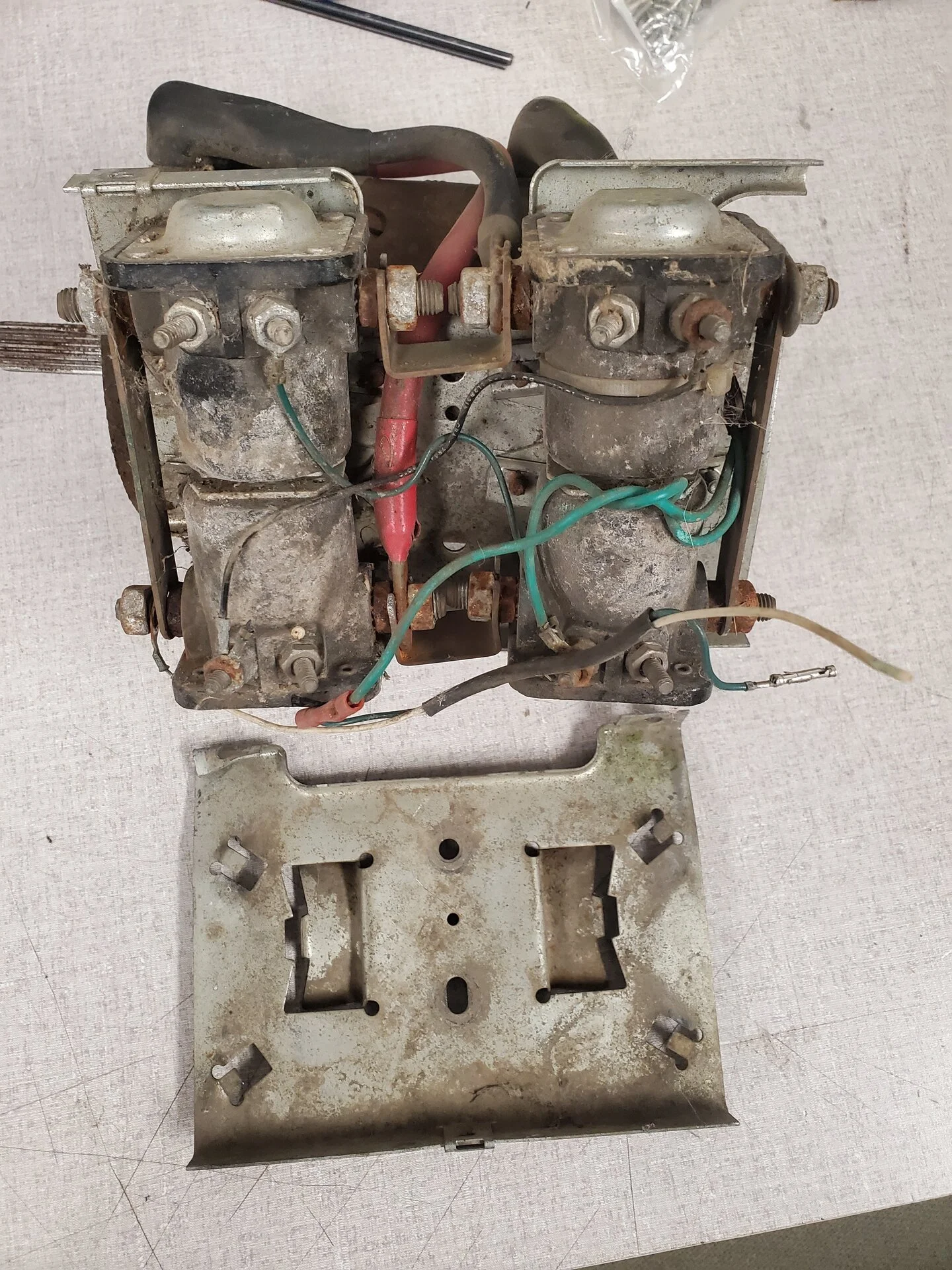

How many variations are there in the control pack baseplate? I'm considering making either an entire new base plate or, if it's feasible, to make an adapter that fits the Albright to the original Warn baseplate.

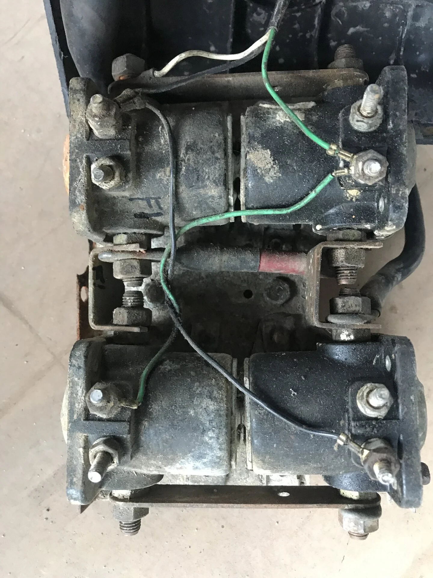

I have 3 8274's here that all use the same control pack baseplate. I have a large size M10,000 from the early 90's that has the same control pack baseplate as the 8274's. Then I have an M8000 I bought new around 2000 and it has a different baseplate- The slot for the wires is long and skinny. The older style has a square opening for the wires at the top about 1.5" square.
Older style top.
Newer style Bottom.
Are there any others?

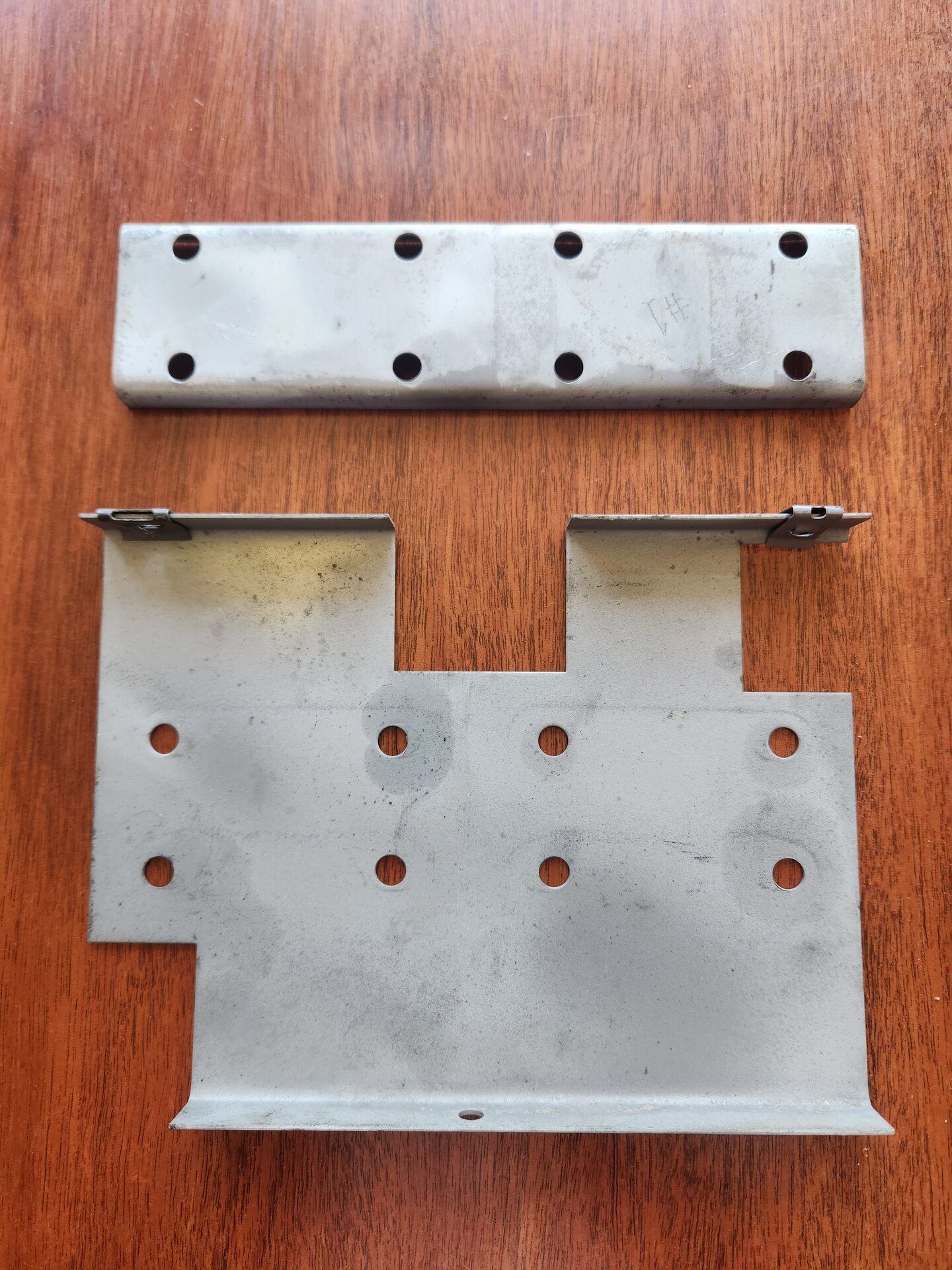

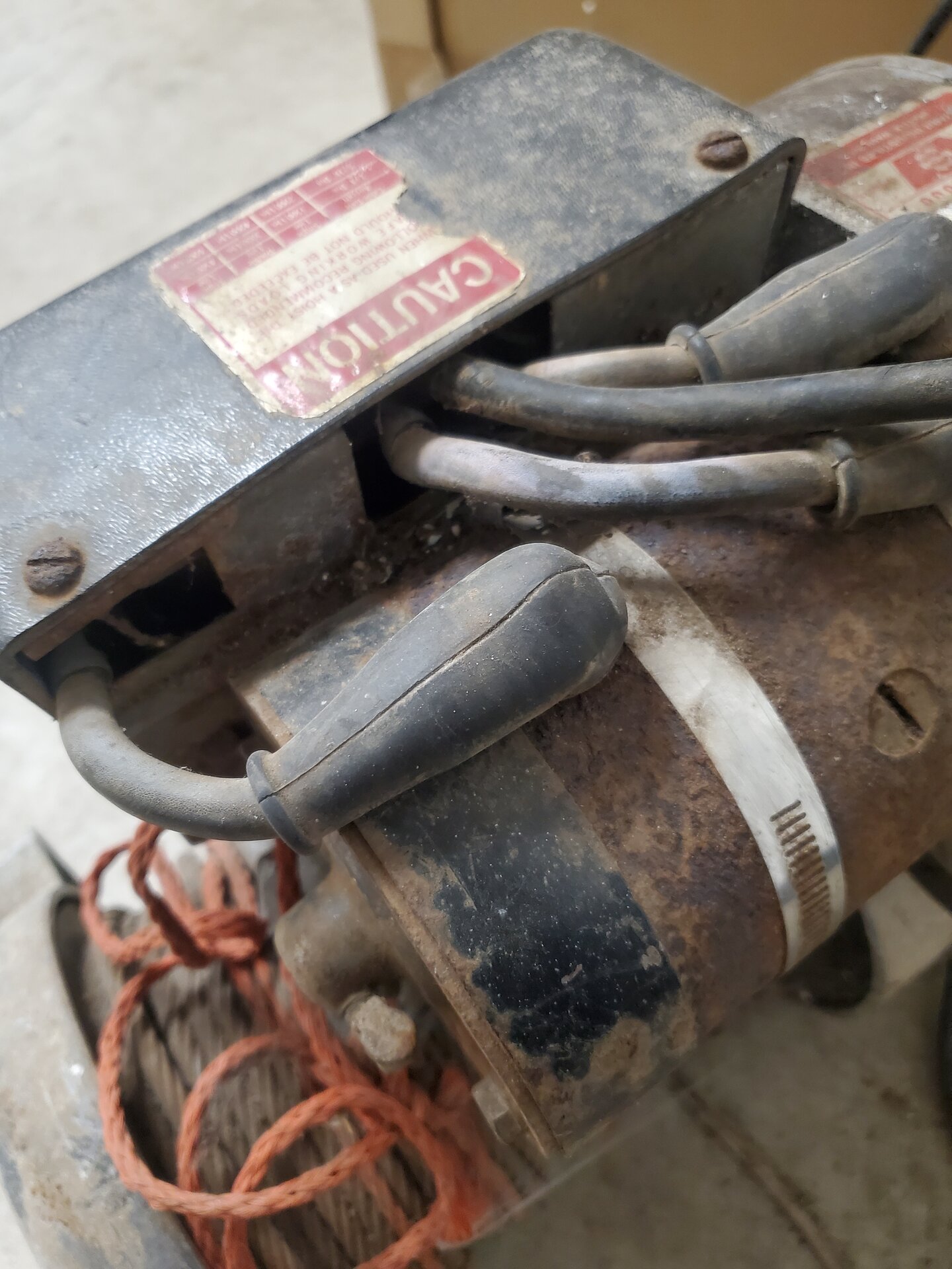

I do know of one other. I've seen a couple in the last 5 years. I'll get a pic for you tomorrow. It's essentially flat with the protrusions to mount against the motor. It uses a bracket that is hose clamped to the motor. The plate bolts to the bracket.

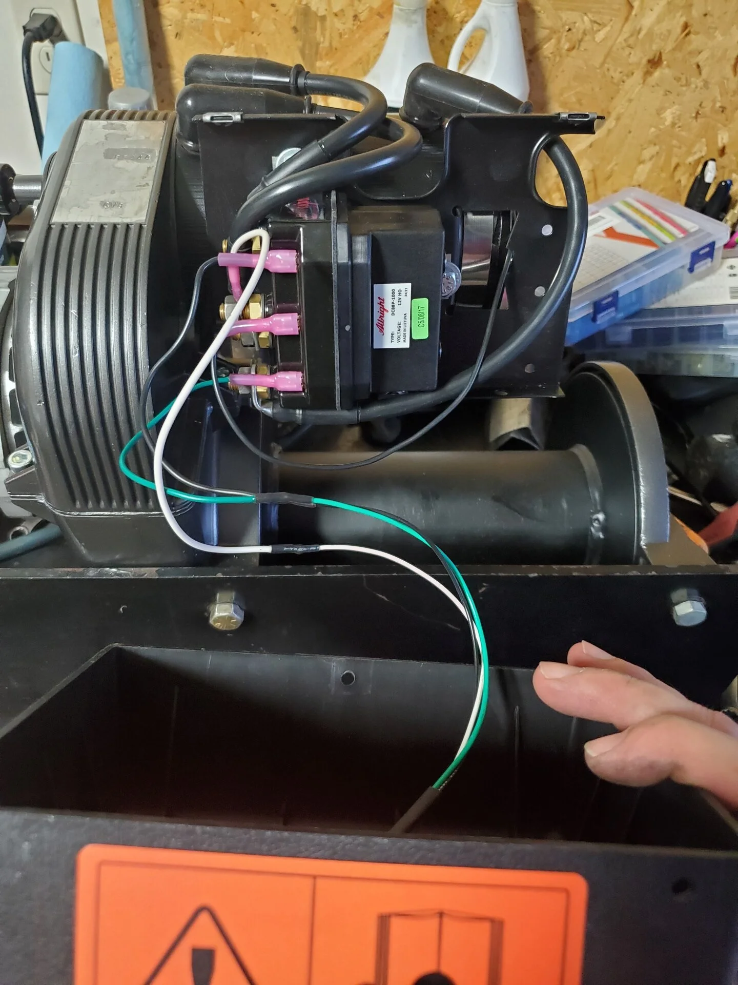

Thanks to Fourrunner for this picture showing how he mounts his Albrights and routes the wires.
When I mock an Albright up on the bench in the same position as Fourrunner I think odds are very good I can make mounts that screw to the Albright and attaches to existing holes in either of the control box base plates I have here.

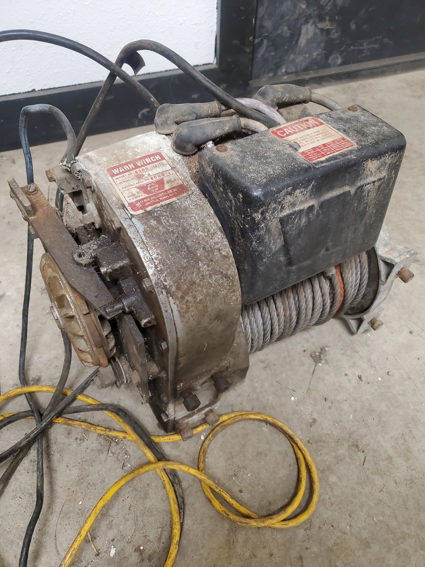

I have one of those! It's on this Warn 8200 I picked up for my '70 Highboy.
That plate must be the first design, before the other two.
Very interesting. I've heard that Warn would mix and match parts often. Probably phased out that older plate after they started the 8274.
Cool old winch btw.

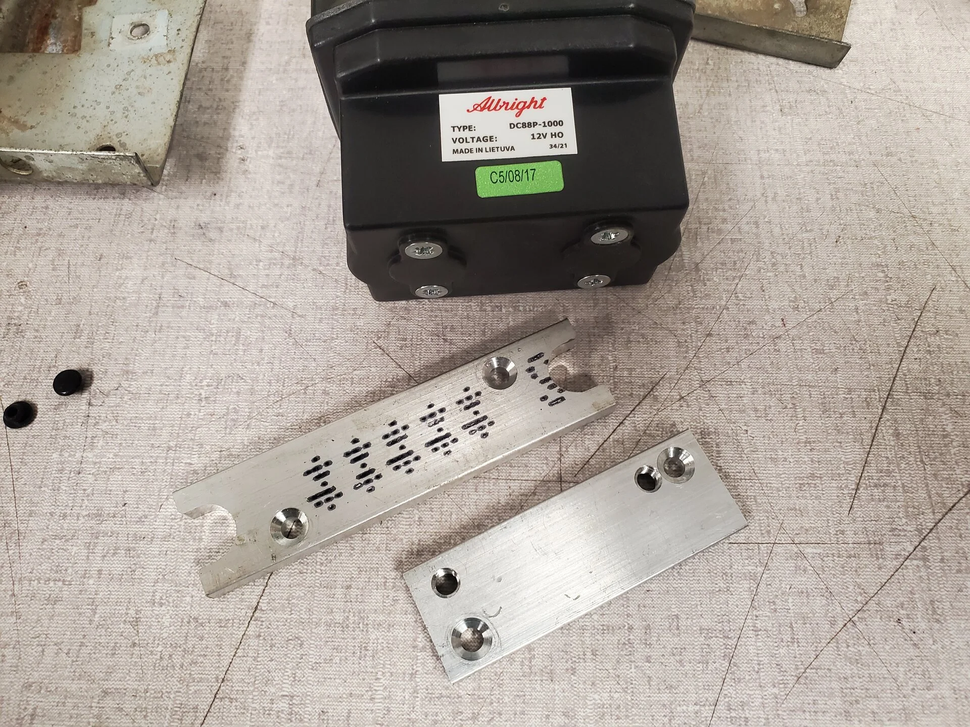

Just an update... To make these Albright mounts I designed a high density machining fixture so they can be made cost effectively. I bought a few dozen specialty fixture clamps for the fixture and they are coming from the factory... They haven't shipped them yet. They say 2-3 weeks from now I should have them. When I get the clamps it won't take long to finish the mounts.
Now we're getting somewhere.
Upper style is universal for mounting to front bumper, underhood, in your golf cart or service truck crane.
Lower style fits the Albright in place of the 4 solenoids in any Warn winch.

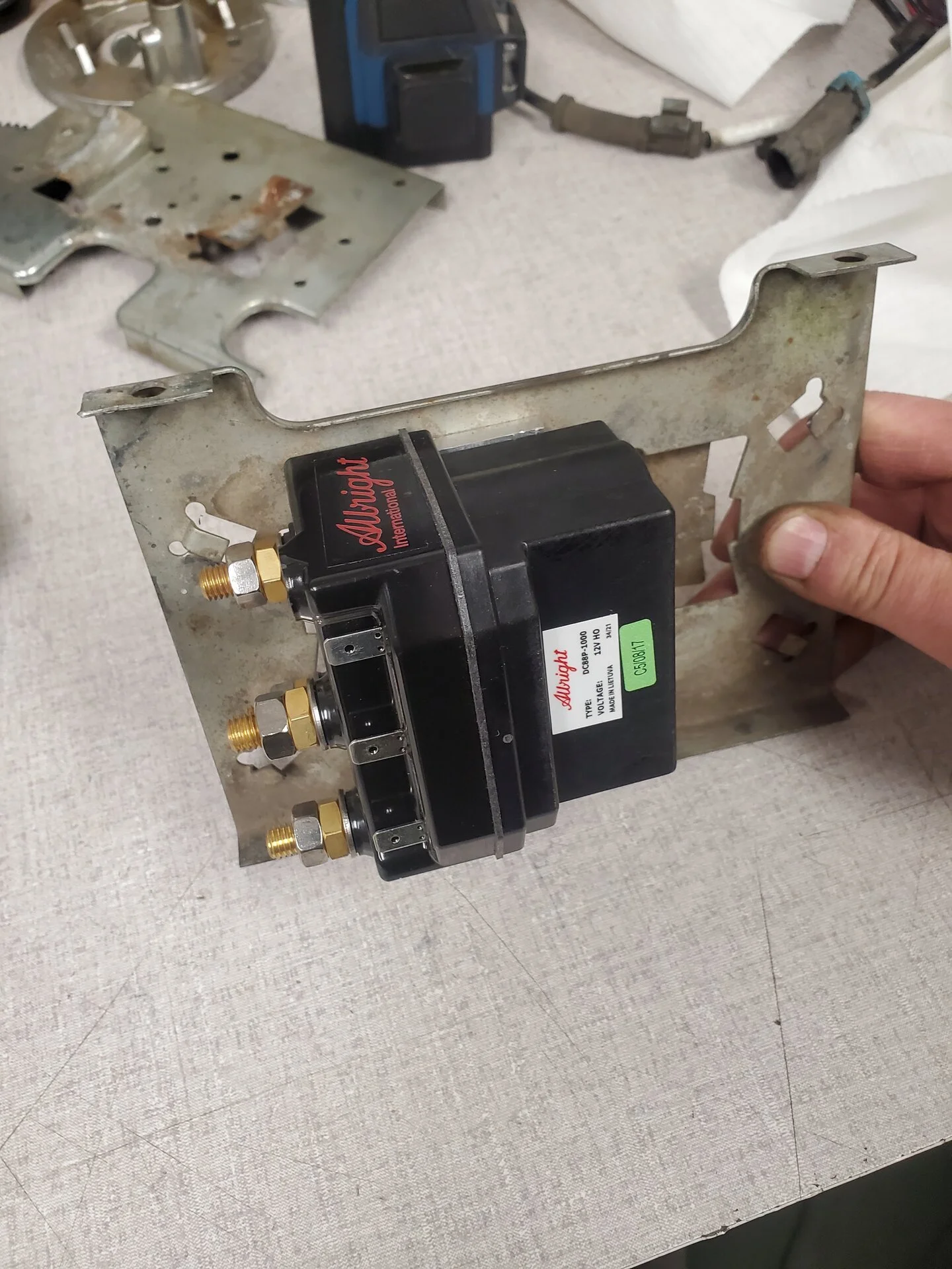

Here's the Albright installed on one style Warn base plate.
Here it is installed on the other.
I didn't plan it this way, but the Albright is clockable right or left facing and shifts about 1/2" up or down depending how you mount it. Not sure that's useful, but it does it. Who doesn't like versatility?
The mounts are USA 6061 and will come with stainless mounting hardware.
The mounts will be going off for anodize next week then they'll be ready for shipping.

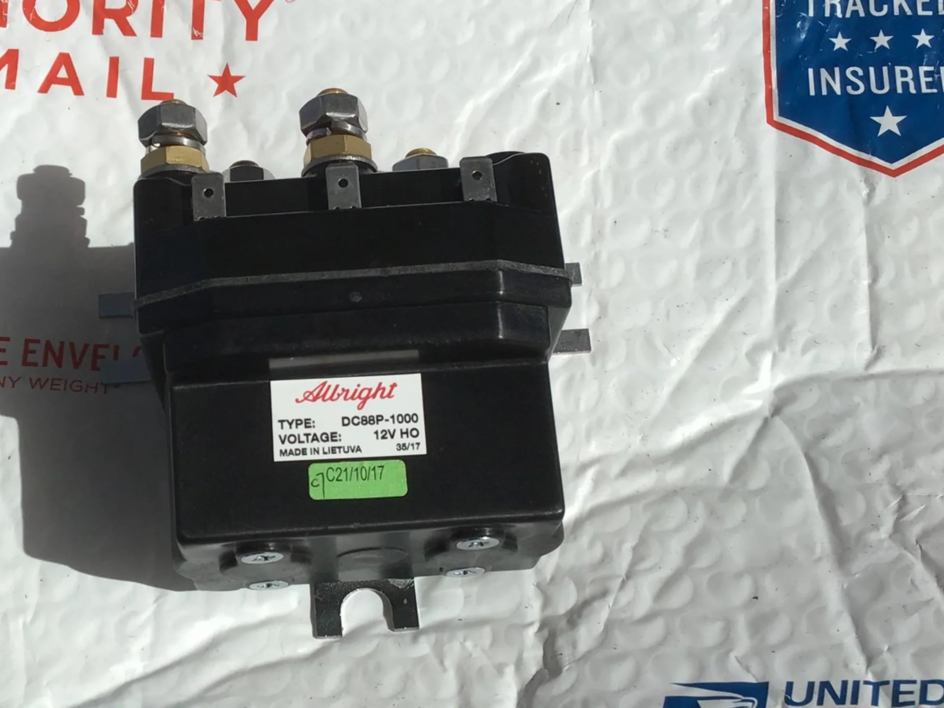

Here’s the one I bought for my 8274, & the one I would recommend. I forget just what the difference was…but when I was doing my research there was a positive difference between this DC88p-1000 & the regular DC88.
