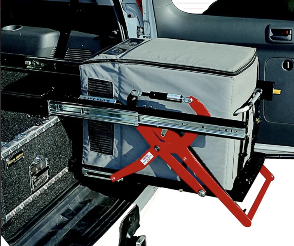

I'm looking for the ones that come out and then down. So I can have the fridge on top of my cargo boxes, but when accessing stuff, it is at the level of the tailgate.
This kind of thing:
In motion here:

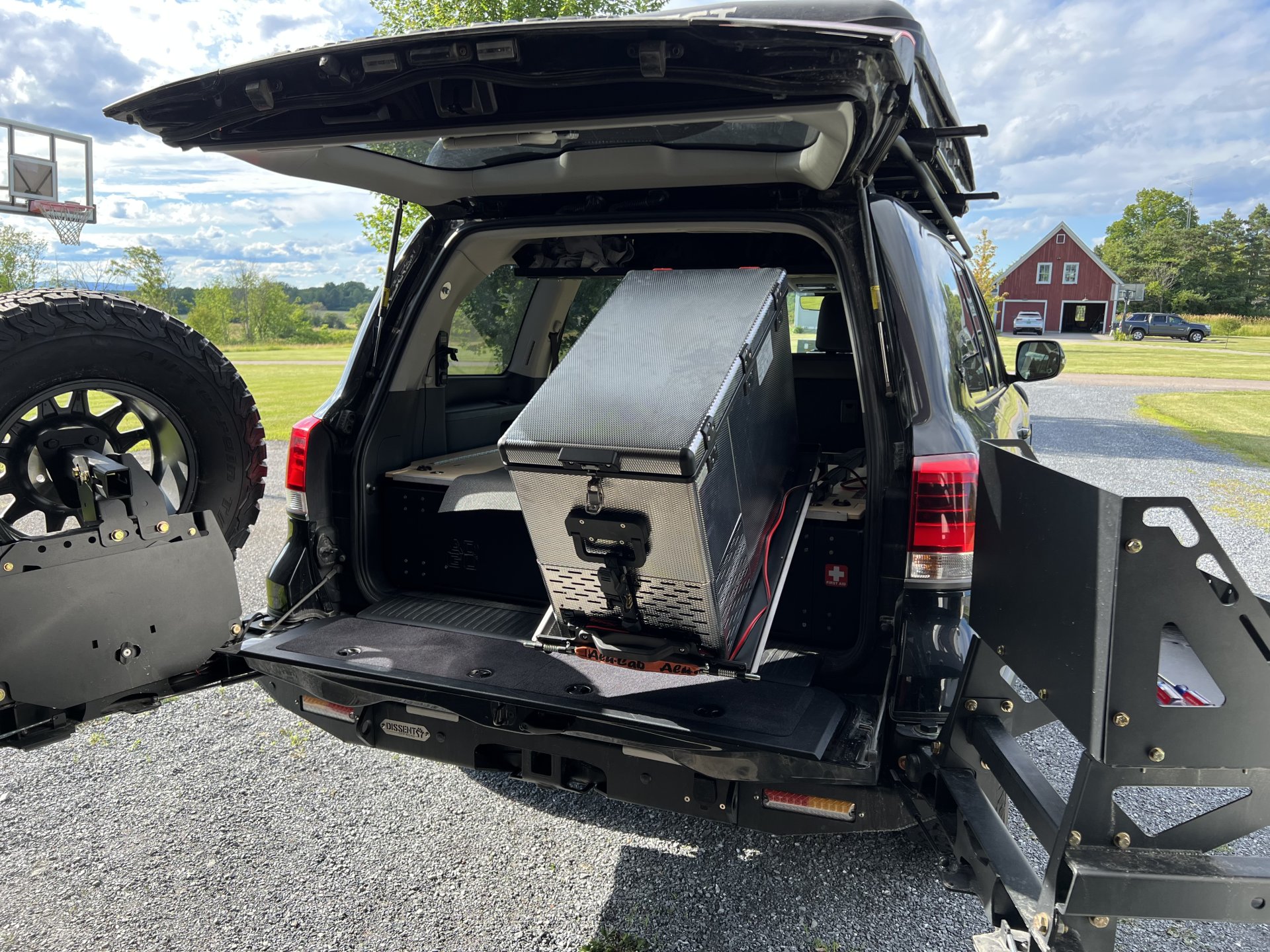

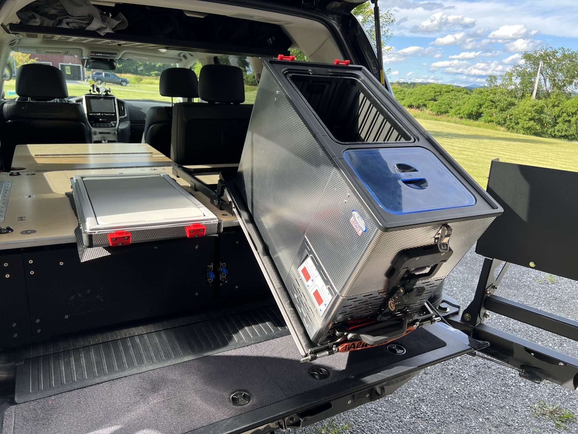

I'm getting an Alu-Cab Tilting Slide.
FYI - Dunn and Watson in AUS will sell the MSA 4x4 drop slide to the US, but freight is over $500 (at least to me in VT). It gets to be a pretty pricy setup. Here is a contact if you want to get any MSA stuff from them: sales@dunnandwatson.com.au
  • Like
Reactions: CT3
So, I took forever to get this done...

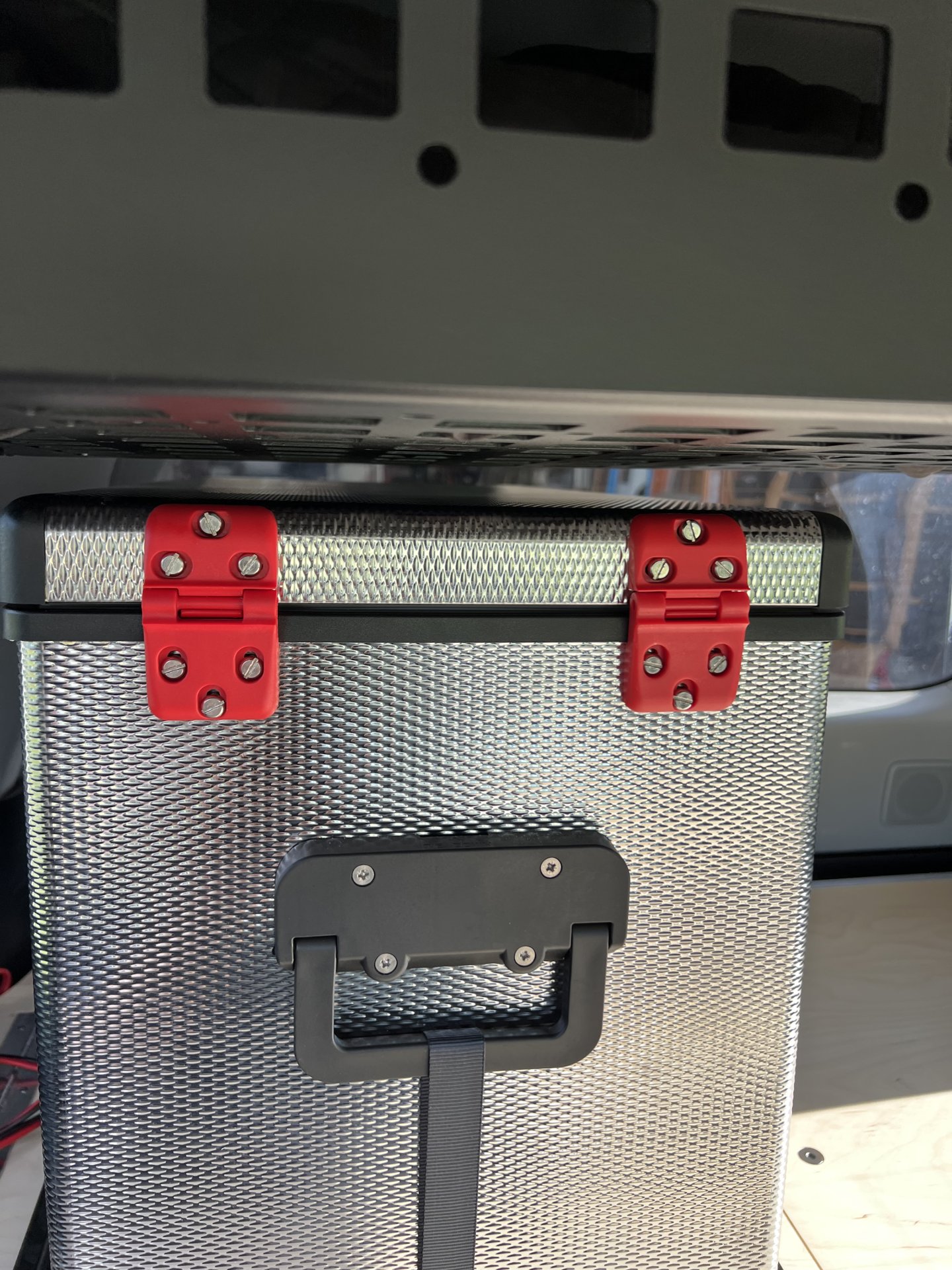

The red hinges are the replacement removable version, which is a necessity in this configuration.
View attachment 3049314View attachment 3049315View attachment 3049316
Wait. I have this same fridge I think, I had no idea I could re-orient the lid like this. I'm also hitting a wall on finding a fridge drop, I could live with tilt as long as I'm not dealing with side opening too, that just doesn't work. Did you just drill new holes in the body of the fridge where you needed them?
Wait. I have this same fridge I think, I had no idea I could re-orient the lid like this. I'm also hitting a wall on finding a fridge drop, I could live with tilt as long as I'm not dealing with side opening too, that's just doesn't work. Did you just drill hew holes in the body of the fridge where you needed them?
The NL fridges are already drilled for side hinges (at least mine is).
You can reuse the same hinges, or get the hinge kit from Equipt that lets you remove the fridge lid:
As said above they have threaded holes for the hinges. They also sell (red) hinges that allow the lid to be easily removed. I think I got mine from Equipt Outfitters (Paul May?).
