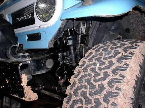

I am currently doing a 60 power steering install into my 78 fj40. Am looking for a source for DOM tubing in short lengths to sleeve the bolts to the frame and added plate on inside. Thanks forward for any help.
I had read people use Black gas pipe (easily available at your local H/W store).
I did the trick where you weld the 3/4" plate to the frame, and tap the holes in the plate. Worked good for me.
Rocky
PS> The first pic is during the install - the plate is now fully welded, and all four bolts are installed.
