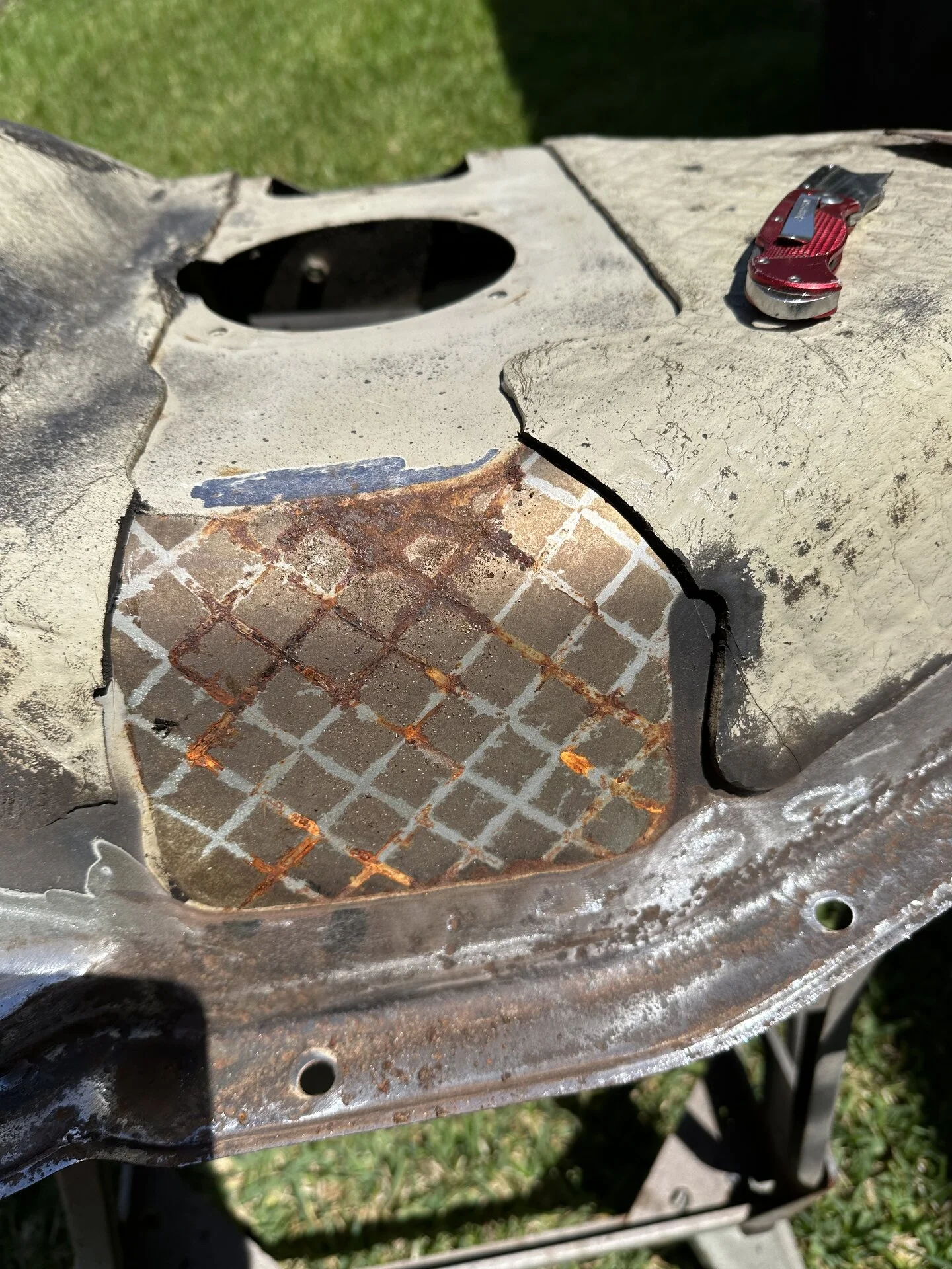

On my series 80 I used Noico brand the thickest I could find. However, on my 76 FJ40 so far the transmission tunnel showed some rust where the asphalt sound deadening was.
so I have not replaced this so far. I suspect if you have a nice water tight cabin, it would not be an issue.
I do have some closed cell foam under the vinyl floor mat, and a 3mm ribbed rubber mat on top.

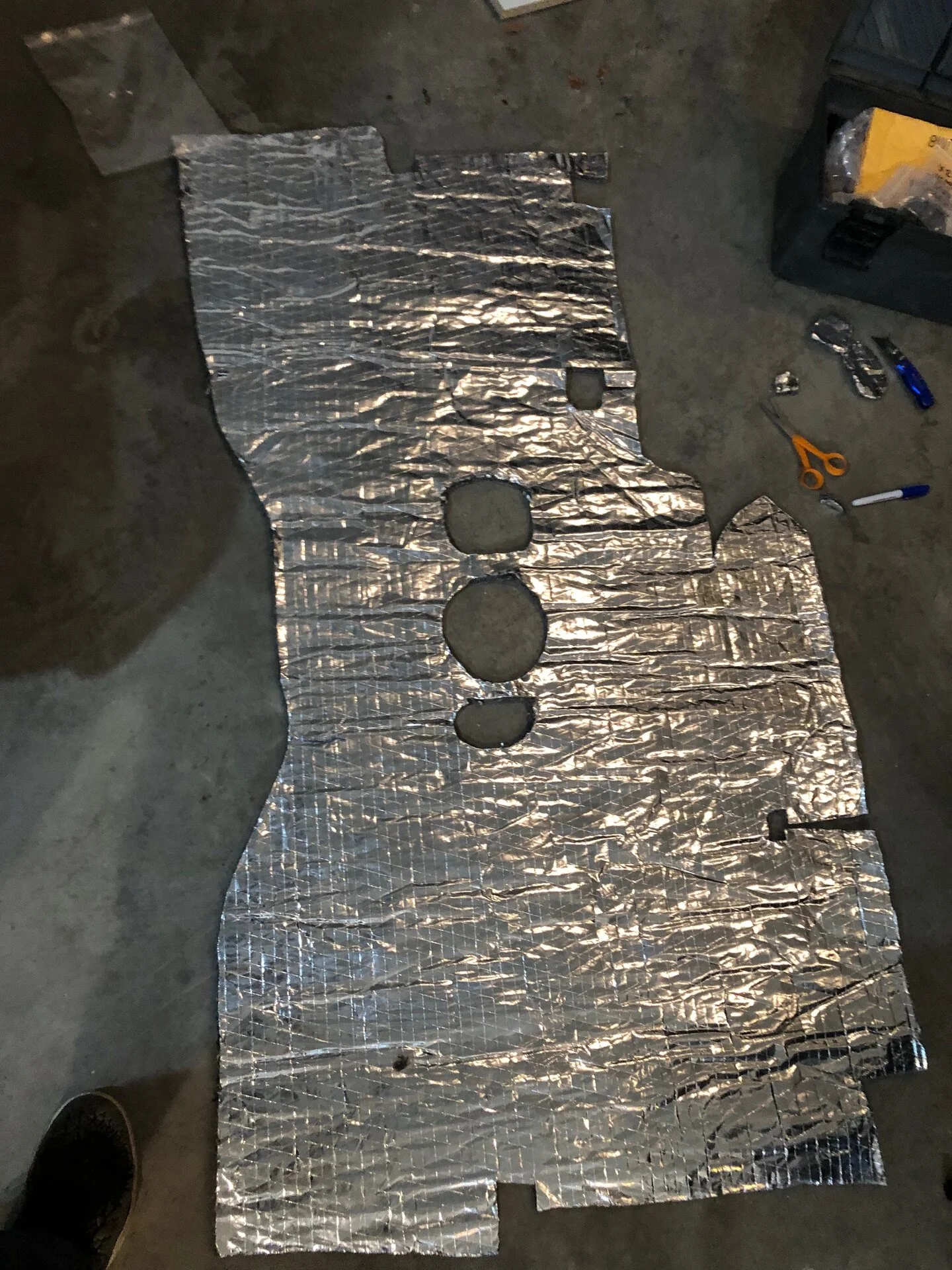

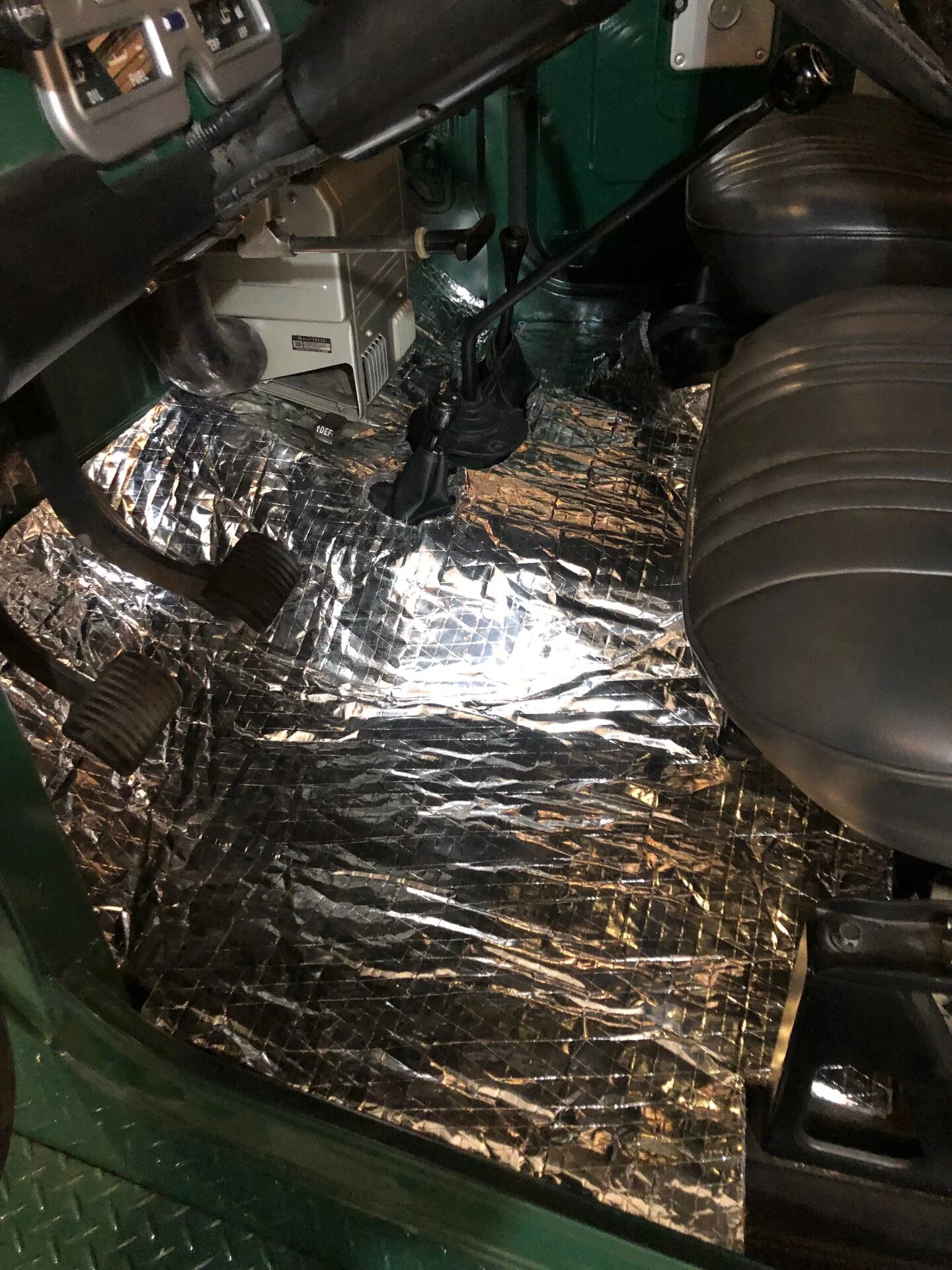

I was reluctant to use adhesive material. So I found foil/ jute material and installed in under the rubber mats in the truck. It made a huge difference for the heat coming into the cab. I also installed it under the rear rubber mat. As far as sound deadening , it still sounds like a tractor. I'm sure it made some difference.
