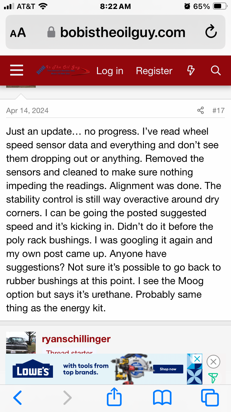

Update (5/14/24): this issue was resolved after I took the truck to Ed Martin Toyota. They found control arms not torqued to spec. Tighten everything to spec. Rubber band steering feeling is gone. Ed Martin is good. Should have taken the truck there for install of new control arms.
I’m getting very close to dialing in my 05 LX470 that I bought back in December of last year. After replacing UCAs, LCAs, shocks, properly adjusting wheel bearings, and an alignment from a good local independent shop, I’ve got just a bit of slop in my steering. For example, if I’m on a road with a very gentle crown, I’m always having to keep slight pressure to the left on my steering wheel as long as it’s under load or especially when accelerating. If coasting, I have to apply less force left with steering wheel- will basically track straight and steering wheel feels straight. . If I’m making a left to turn onto a highway, as soon as I straighten out, I have to keep steering wheel cocked about 10-15 degrees for a little while and then straighten it out gradually. Also, there’s about a 1/2” to an inch” of dead / play when steering wheel is centered on the road. I feel like I have to chase the steering more than I did before all the suspension work. Everything else is nice and tight in the front end- including tie rods. Rack is OEM Lexus for VGRS system and was replaced maybe 4 years ago / 30-40K miles ago. I’m thinking it’s slop in steering rack bushings and am considering swapping in some Whiteline or Super Pro poly bushings. Anyone have a similar experience and make a switch to poly bushings to achieve tight steering again?

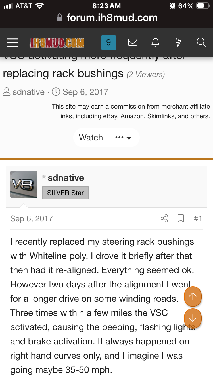

Sounds like some guys have had great luck with them, move forward how you see fit. I just replaced an entire rack on a 2002 to get rid of the issue, previous owner installed super pro kit on a brand new OEM rack, could not take off ramp turns without the the VSC engaging. 2 months ago I did an 04 Tundra limited that had VSC, a shop installed the Energy kit and that point on it was un-drivable. This guy had the VSC zero point calibrated by the dealer for $190 and it did nothing.
from a simple Google search I found these to kind of mimic what I said. Even long time Mud member.
I believe you. I would love to hear if others are experiencing this issue after swapping to urethane bushings. It sounds dangerous and is definitely not desirable. I have a long 360 degree on ramp near my house and would hate to have the VSC engage on especially my wife. I would NEVER hear the end of it.
Scares people when they are not expecting it, feels like you are getting rear ended lol.
Once you know it’s there you can drive around it but it’s annoying! Only fox is to swap in new rack.
Wife would hate it for sure!
I have had this problem for years and as I think back, it started after I replaced the steering rack and the shop used urethane bushings! I hate it, it's dangerous and very alarming to say the least. My VSC will mostly do this on sweeping right turns like mountain roads as the system tries to put you into oncoming traffic! I know I need a new rack again so I am going to go back to the rubber bushings and hopefully solve this issue. Now I am very motivated to replace, this is the motivation I needed.
