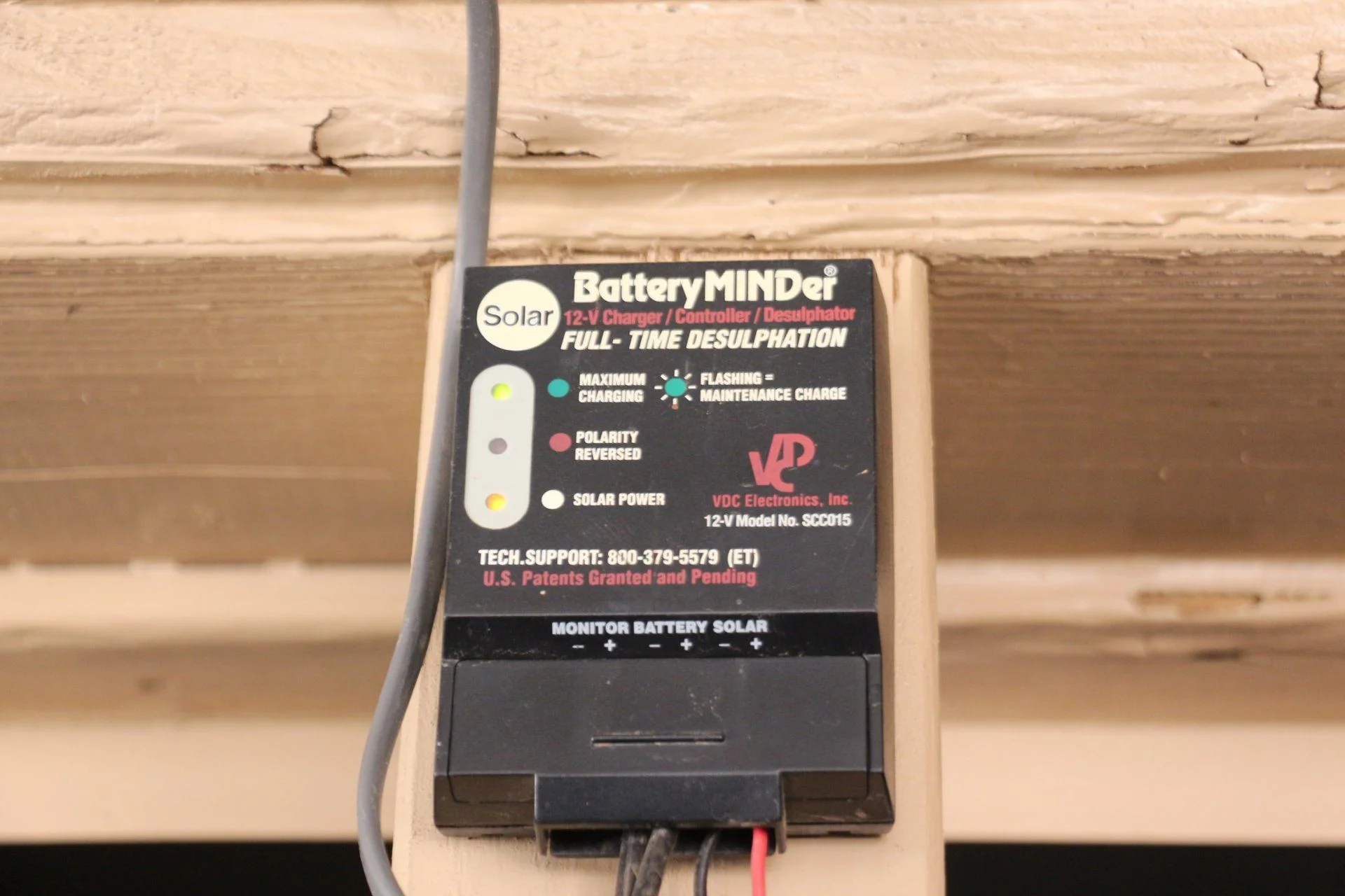

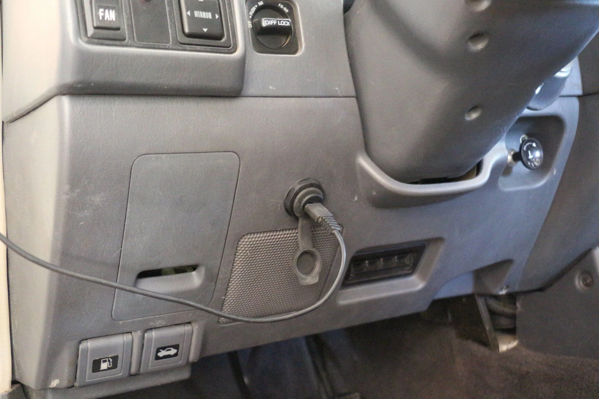

Because my 80 is not a DD I wanted shore power for my batteries. I have found keeping batteries fully charge gives them much longer life and what better than solar. I have used the Solar Battery Minder set for several years with excellent results. I mounted the panel on top of the covered area where the 80 rest and mounted the controller high up but easy to see. I wanted an obvious connection point so I did not drive off plugged in.:doh: I mounted the SAE connector so it is easy to plug in and hard to miss when I go to leave. If I plug it in with fully charged batteries it will keep all 180AH charged.
Can you expand a bit on how it's wired into your interior and then to your battery(s)?
LCP style simple - The SAE connections is wired to the always hot side of the factory fuse box. My batteries are wired in parallel and never separate so they both charge together.

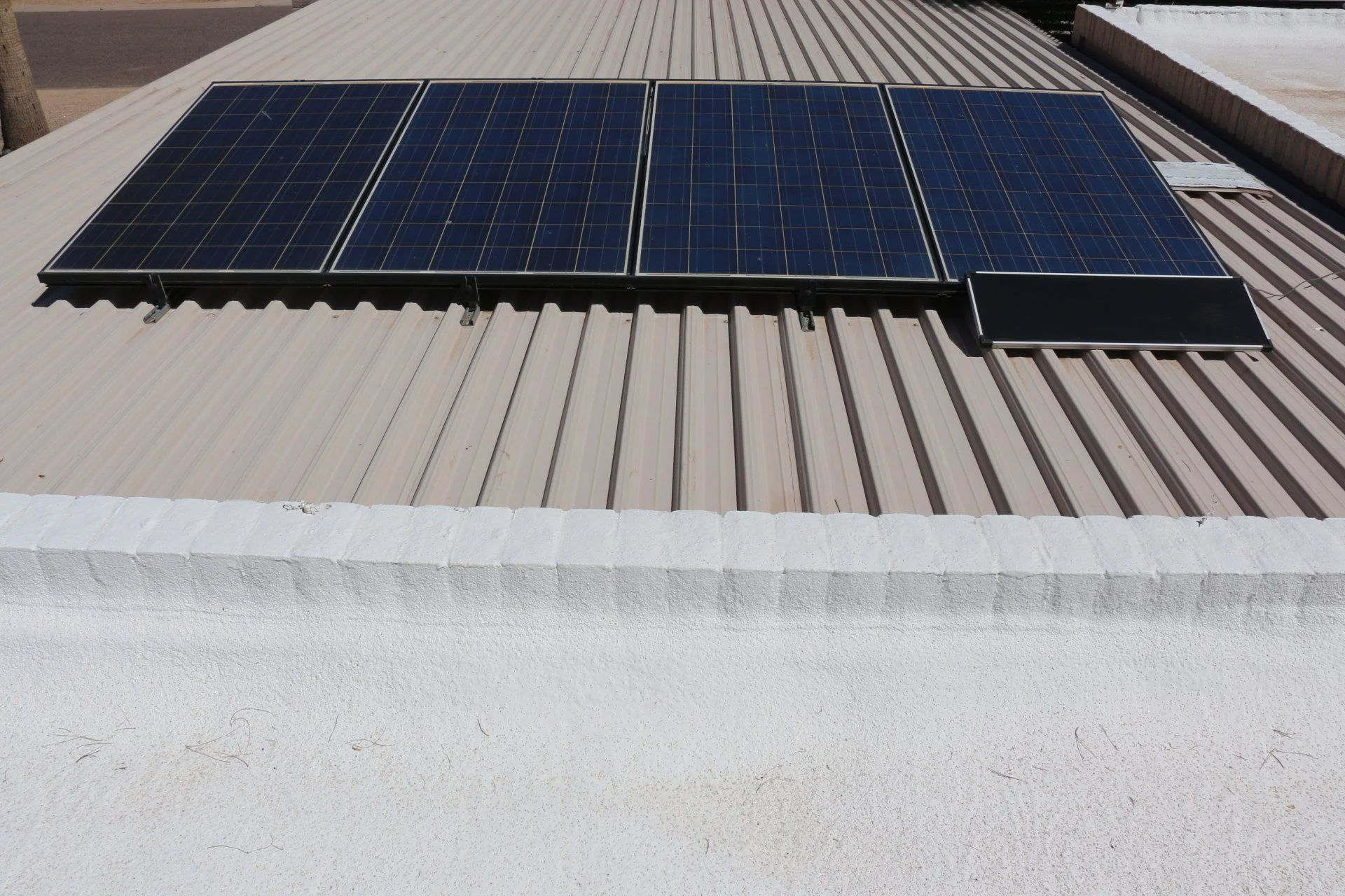

Pretty cool! How big are the solar panels and how many watts do they generate?
I use a Renogy "solar suitcase" to keep our two travel trailer batteries charged. It generates 100 watts and using it about 90 minutes a day (with full sun) will keep things going until the next day.
It does not take near what you have available to keep batteries charged, slow and low is better when it comes to batteries. 15watts/1.2amps Its the small panel seen below
