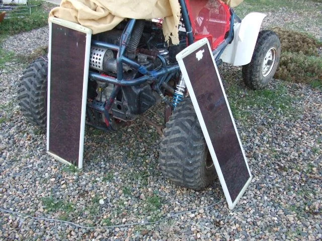

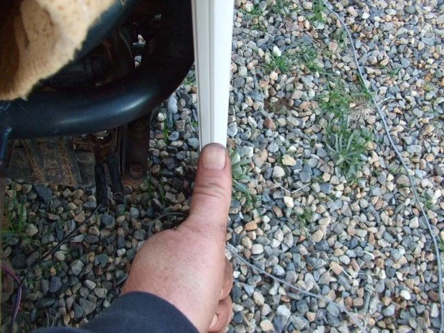

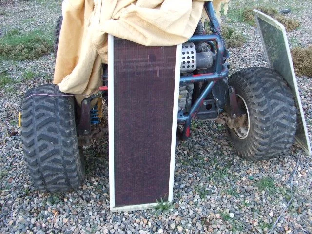

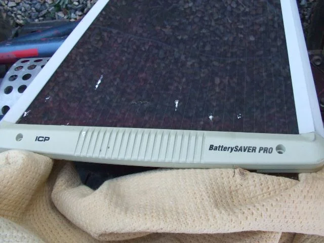

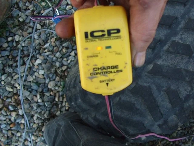

24V 15w panel
Measures 38" x 13" and is about as thick as my thumb.
Neighbor has two of them hooked to his Honda Pilot to keep the battery charged. (He is a tight azz and won't buy a new battery.)
24V 15w panel
I'm surprised with the panel at near vertical they do much of anything.:eek:
