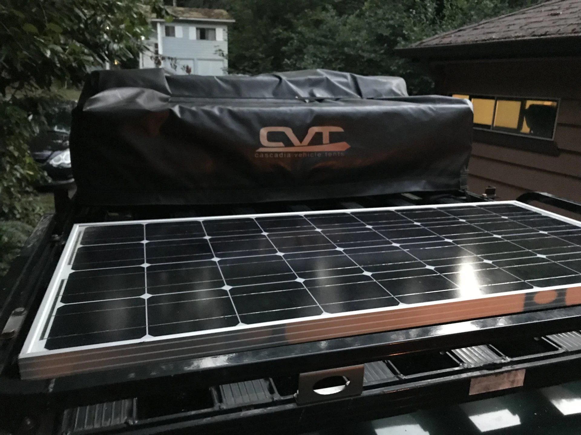

I'm using one maybe two he.he.he 100-Watt Polycrystalline Solar Panels & controller feeding to auxiliary battery. I feel like if I even get 1 hour of direct light it will be enough to top off battery which is what I'm looking for. Permanent fridge setup.

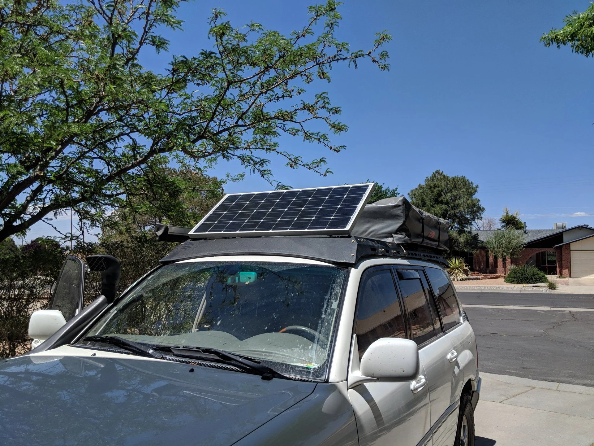

I've had mine on for about 4 months now. I love it as it keeps my single battery from draining with the fridge running over a few days.
I ran the wiring down the driver windshield then through a boot in the firewall. I then ran it to the front of my drawers where I mounted the controller. The wiring from the controller then taps into the battery circuit at my blue sea fuse box in my drawer.

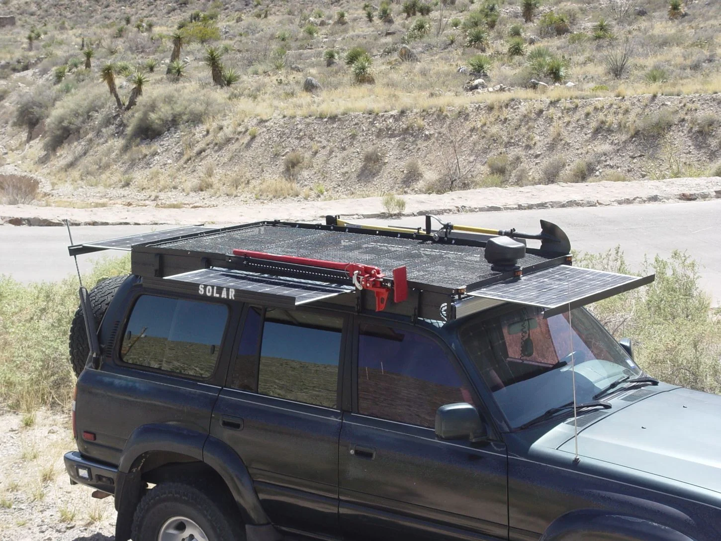

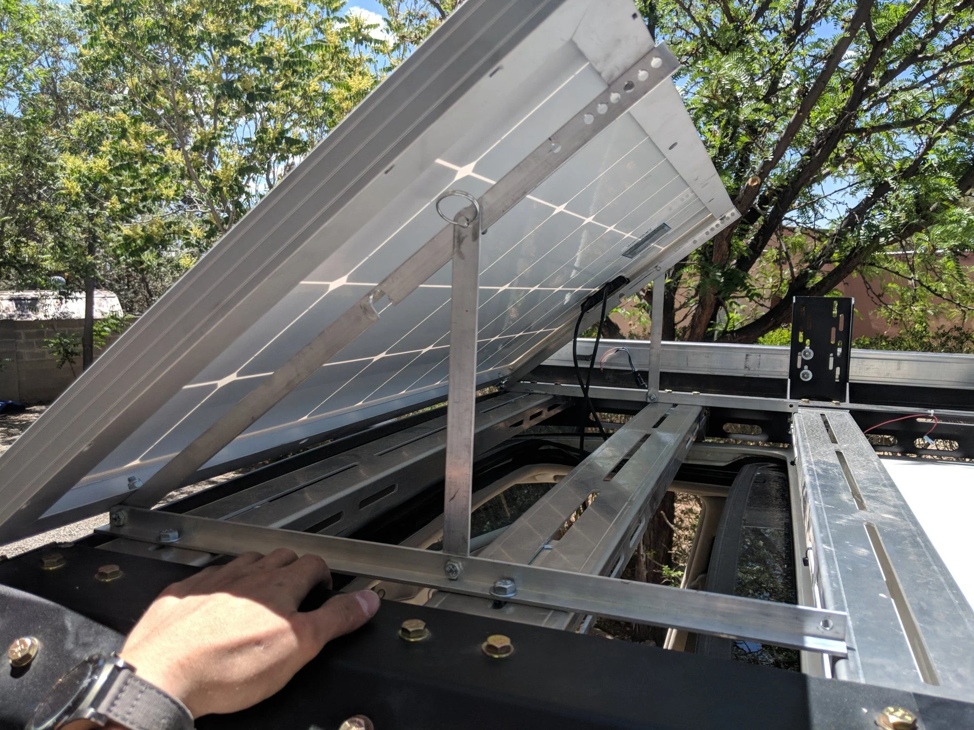

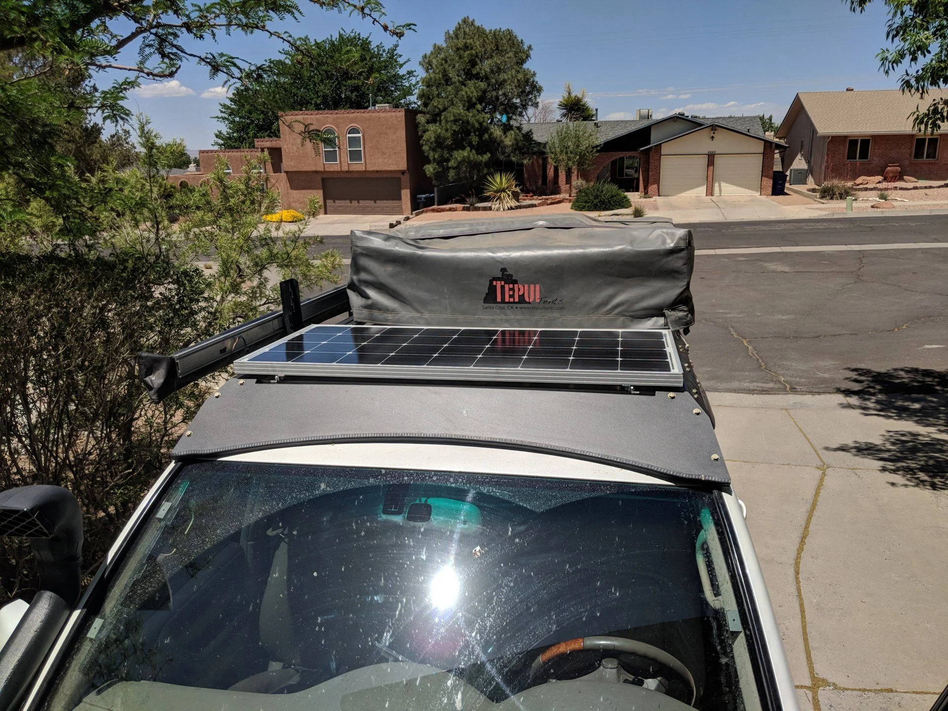

I have done some hobby work incorporating panels into roof racks in the past and first would recommend that you ditch the hard glass panel for a flex panel if you plan on adding more panels in the near future as I did.View attachment 1796999
I love the flexible solar panel setup. Do you mind sharing how you mounted to your roof rack and how it retracts and pulls out?
